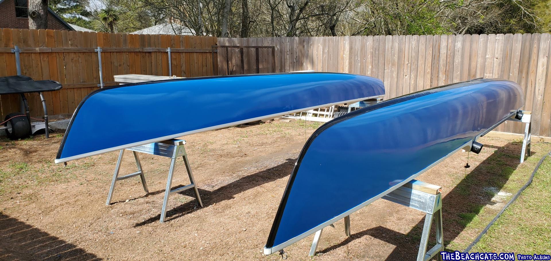

I looked at the various options, since where I beach at, there's tons of shells and rocks embedded in the sand, etc. and already fixed some divets. Found the stuff tailor made for hull protection, but it's pretty dang expensive, IIRC. Couldn't find "just UHMW Tape", though I'm sure it exists. Out of frustration and time, I ended up taping off my hulls and adding a wear strip of UV-resistant epoxy with black tint to help in UV resistance. Figured it would be very easy to repair; just sand an paint more on like gel coat, only tougher and easier to deal with; it can be thickened also, so easy to do on the trailer.
Don't know how it'll work...been a slow start to the season, to say the least.

So, when you look at the graphite additive, it actually softens the finished layup; that's why I skipped it. I did add some colloidal silica into the epoxy to thicken it to something thicker than latex paint to get the wear layer depth I wanted, and then of course tinted it to look better. Came out tougher than the original fiberglass, but still the jury's out until I can hard test it. I've seen this done before somewhere on a catamaran, so someone's figured this business out I'm sure. Might explain the plain-old "bottom job" threads...old fashioned fixes for a reason; they likely "just work". No free lunch.
