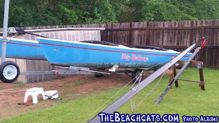

  • Started about here with my boat, fresh home from purchase:
    https://www.thebeachcats.com/gallery2/main.php?g2_view=core.DownloadItem&g2_itemId=134453&g2_serialNumber=4

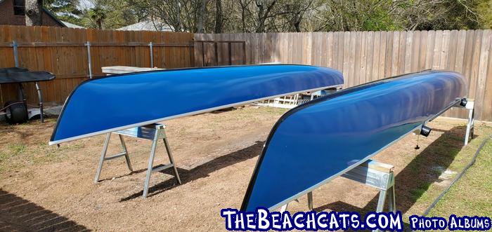

    Here's where we are today:
    https://www.thebeachcats.com/gallery2/main.php?g2_view=core.DownloadItem&g2_itemId=134462&g2_serialNumber=4

  • In case anyone is wondering:
    1) Completely tear down cat; H21SE is actually scary-easy to tear down. Wash throoughly.
    2) Rough sand with a Makita 7", variable speed sander/buffer with a soft, velcro backing pad (can't use a hard pad on fiberglass without gouging it).
    3) Wipe down with solvent, draw the wear strip lines and tape off area to get epoxy; rough up with 80 grit, wipe with acetone then mix epoxy with UV clear hardener and add black pigment. Remove tape while epoxy is still "green". Ignore bugs in epoxy (they're "reinforcement").
    4) wet/block sand after filing in little gouges, etc. with epoxy. Wet sand entire hulls.
    5) Prime with Interlux 404 Epoxy Primekote, wet sand with 220 and...repeat.
    - wet down grass and dirt; everything with a hose/water to contain dust and bugs (this works).
    5) Light spray of the Interlux perfection; ignore bugs. Wet sand with 220
    6) Final spray after wipe down following Interlux instructions on can.
    Lessons learned -
    1) You have to just stop and say "good enough is good enough". Could likely got show-car results if I wanted to fill, prime and repeat for another week, but it's getting warm. Need to sail and this is a 30 year old boat.
    2) The H21SE's are built SOLID - I expected to uncover massive repairs/get surprises since it was painted previously over the original gray gel coat, but there wasn't. Just 1 good solid repair from what looks like roller damage sometime in the past. Nice.
    3) Conflicting data sheets from Interlux; if spraying, you do not need, or want to thin past about 10%. 20%, as listed causes sagging. I only got one sag, though; the entire side of a hull...wet sand.
    4) The NEW HF HVLP gun has a re-designed spray cap and internals. It's actually a GOOD gun (this is the model with a black internal nozzle). The old $12 purple gun, I basically would buy for primer jobs and once spraying epoxy primer would throw away after 2 sessions due to the mess. So, I used the new $12 gun to shoot the finish coat. Did as well as my DeVilbiss GFG-Plus gun, which is scary/impressive.
    5) I used a plastic drywall sanding block that is padded for blocking the boat/wet sanding. That worked way better than I thought and prevented the paper from digging in, etc. And, was cheap.

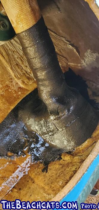

  • Why all the prime, etc. efforts? Had to repair the wings, - permanently (as possible).
    A little carbon fiber wrap, to make it go faster, of course:
    https://www.thebeachcats.com/gallery2/main.php?g2_view=core.DownloadItem&g2_itemId=134465&g2_serialNumber=4

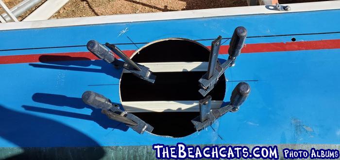

    Then, as a modification to the "jack-o-lantern" technique of opening a hull, I used fiberglass battens to back up the circle:
    https://www.thebeachcats.com/gallery2/main.php?g2_view=core.DownloadItem&g2_itemId=134459&g2_serialNumber=4

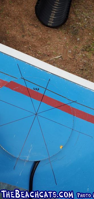

    I drew an "X" across the circles I cut out so they would go back on perfectly and match the curve of the boat. This is what it looks like before sanding, etc.:
    https://www.thebeachcats.com/gallery2/main.php?g2_view=core.DownloadItem&g2_itemId=134473&g2_serialNumber=3

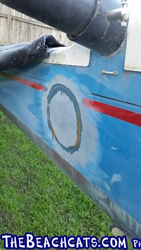

  • Looking for some strip-down and primer shots, but I think I didn't get any. Got some more boat-hole marking, etc.:
    https://www.thebeachcats.com/gallery2/main.php?g2_view=core.DownloadItem&g2_itemId=134476&g2_serialNumber=4
