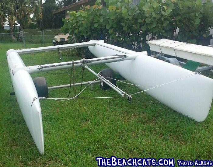

I've put a picture in my album and here is my shot at posting it:

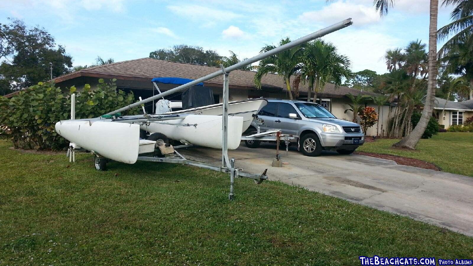

My buddy has gotten new wheels, tires, and bearings on the trailer. I'll be keeping the old ones as spares. I plan to leave in a little over a week.

Very nice. Looks like a good score with the galvanized trailer, beach wheels, and cat box.

Thanks. It was a project that he was sharing with a friend and co-worker. Unfortunately the co-worker died in a plane crash and he lost his enthusiasm. Along the way they rebuilt the trailer as it had rust issues, and it has not seen water since the rebuild. The stays are in poor shape and he is afraid to rig it. He has all the cables and thimbles, I just need to refabricate them. The purpose of the hobby is to collect tools so I'll be buying a swaging tool.
