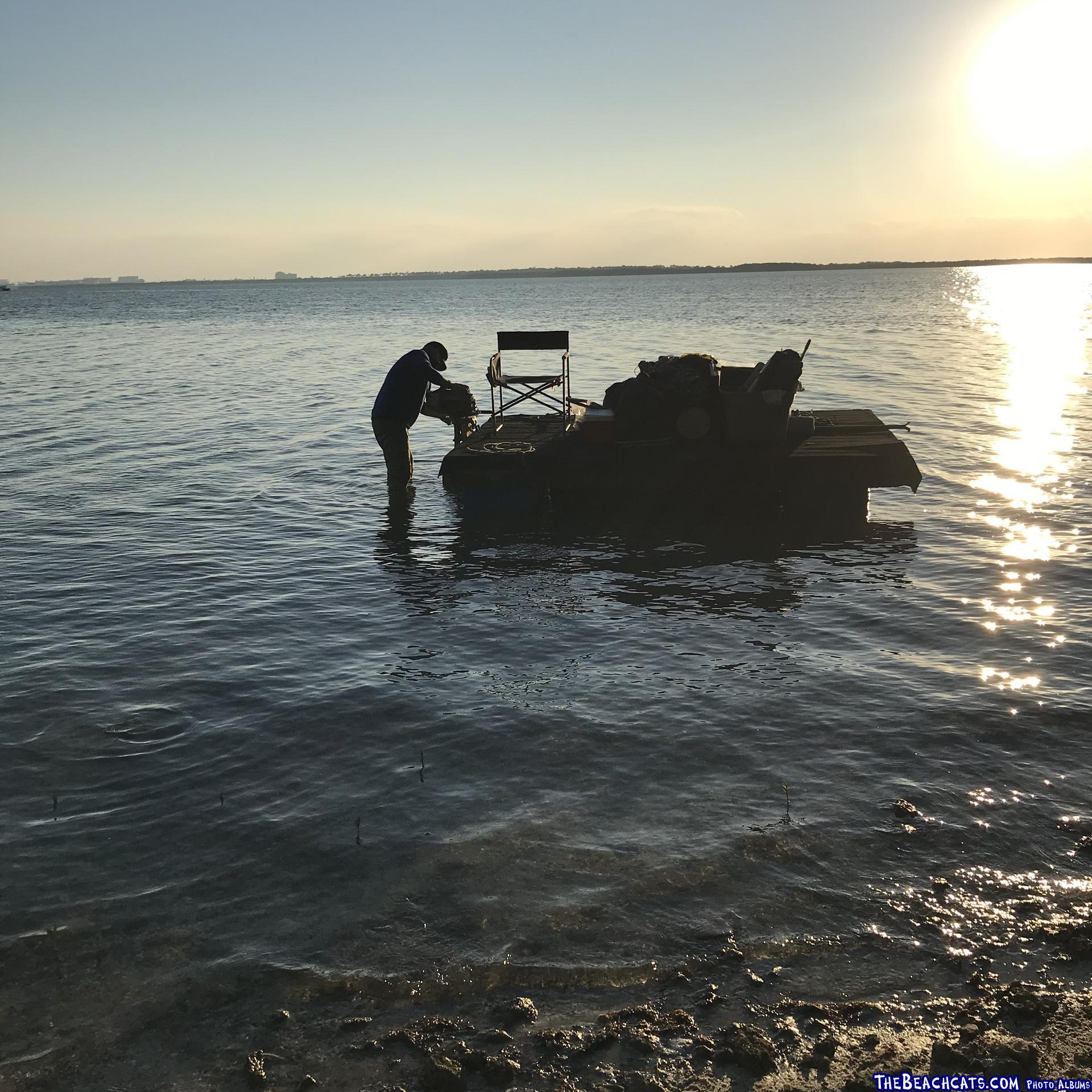

  • here is the solution:
    get a bit of a dock - add a 3.5 tohatsu
    done
    https://www.thebeachcats.com/gallery2/main.php?g2_view=core.DownloadItem&g2_itemId=133840&g2_serialNumber=3
    (our friend's powerboat and jetski were broke and he wanted to get his tent up for our thanksgiving island camping)
