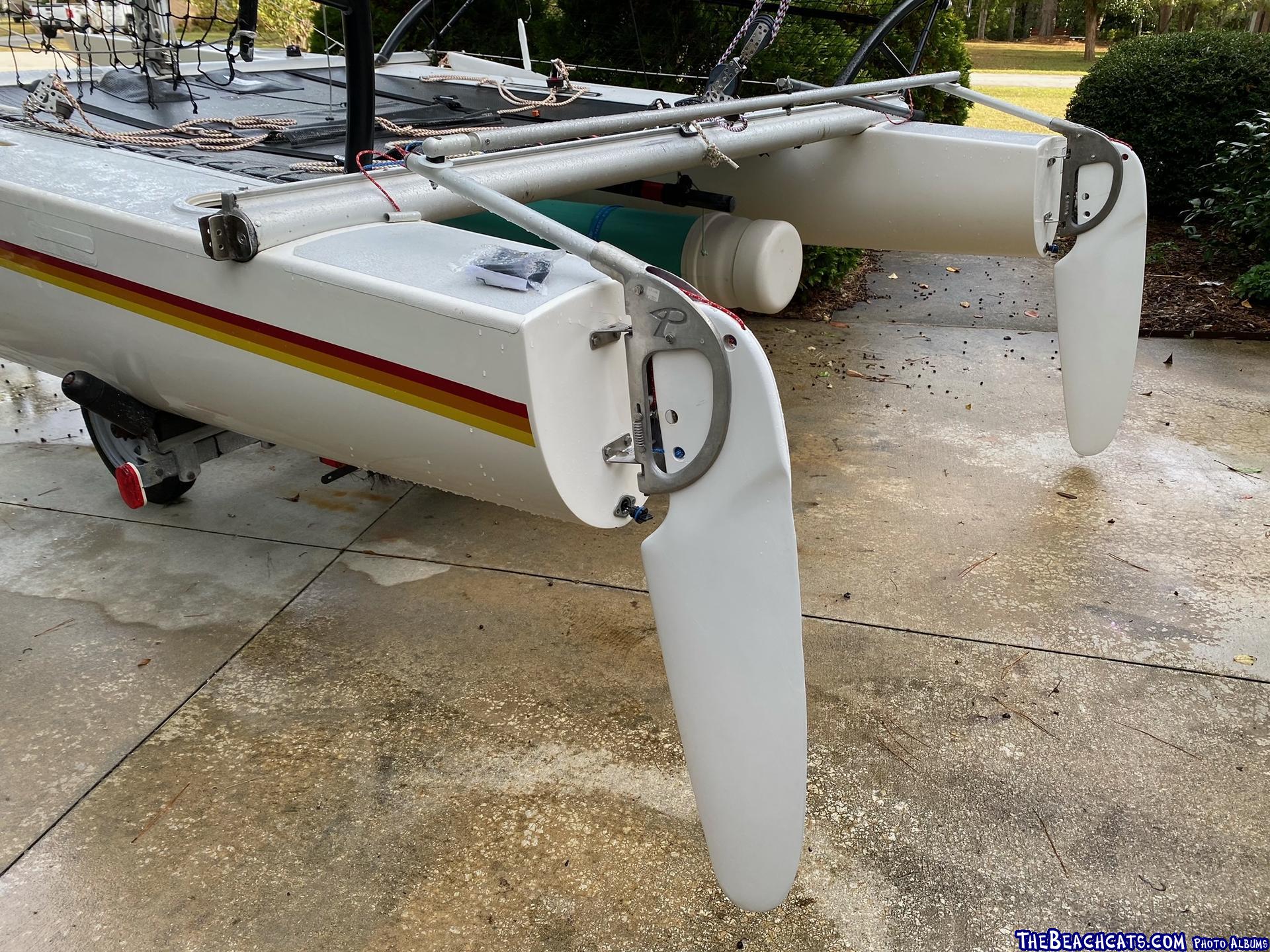

    Second issue is at speeds above 15 knots the rudders pop due to water resistance. Yesterday we were flying the main only, doing about 12, deployed the jib and took off, within 30 seconds both rudders had independently popped, making the boat a monster to handle and nearly impossible tack. The previous owner glassed over the adjustment bolts for reinforcement,.....is the only solution to buy new rudders and hope the new system works properly? There is a set of MX rudders available, but at $600 its 20% of the boat's cost and hard to justify.

    QuoteThe previous owner glassed over the adjustment bolts for reinforcement,.....is the only solution to buy new rudders and hope the new system works properly? There is a set of MX rudders available, but at $600 its 20% of the boat's cost and hard to justify.
    Out of my area of expertise but can't you sand them out?
    also - i paid $800 for new hobie18 casting, on my $400 hobie 14 years ago - $600 for a set doesn't seem to terrible

    You can see in the photos the glassed over rudders,...I am wondering if replacing the springs and catch mechanism will make a difference since it was done only a few years ago. Cheaper solution to try anyway.
    https://www.thebeachcats.com/gallery2/main.php?g2_view=core.DownloadItem&g2_itemId=133652&g2_serialNumber=3
    https://www.thebeachcats.com/gallery2/main.php?g2_view=core.DownloadItem&g2_itemId=133653&g2_serialNumber=3
    https://www.thebeachcats.com/gallery2/main.php?g2_view=core.DownloadItem&g2_itemId=133654&g2_serialNumber=3
    https://www.thebeachcats.com/gallery2/main.php?g2_view=core.DownloadItem&g2_itemId=133655&g2_serialNumber=3

    On the rudders... It sounds like the last owner filled the large holes in the rudder where you get to the inside nut of the rudder locking bolt? That's crazy. If you want to restore the adjustment, you might try loosening the exterior nut, then put a wrench on the latch and see if you can break it free. This would only allow you to adjust in one direction, which would induce weather helm, and also (in what I consider a design flaw) will make the kick up issue worse. But if you are able to remove the bolts, you could then drill out the epoxy restoring the ability to adjust the locking bolt. Moving them in will make them latch better, but may also induce lee helm which you definitely do not want. Another option is to replace the rudder springs (available at Murrays.com), or the rudder locking bolts if they are worn and you are able to remove them. Another idea is to take a wrench to the latching bolt and try to bend it up. I would not do this while it is installed as you might crack the rudder.
    Finally, as a last resort you can add jam cleats to the tiller bars and cleat the control line that lowers the rudders. I've got one rudder that just started kicking up at high speed (at 18 knots yesterday). I installed the cleats for the raising lines because I don't trust the v cleat to kept my rudders up. It turns out these are great to use with the control line that lowers the rudders if they are not staying down. And if you use 3/16 line, the line will break if you hit something. (Found that out on Weds when I put the boat into some rocks which is another story.)
    At some point I will deal with my kick up issue, although it only happens at very high speeds, broad reaching.

    Speaking with the prior owner, he claims he never had issue with the rudders popping, so perhaps springs will be enough. As in your situation, they only seem to go when we are in the upper teens for speed, but that's also when I need them down. Lol.
  • theblackpearlBill that was super helpful thank you! I will try all your suggestions! If the problem with the rudders persists I will just throw down the money for the generation two MX style rudders. I don't anticipate selling this boat, so it may be worth it long term. The cleat idea may be the best immediate fix. I believe a contributing factor is the additional width created by the "reinforcement" that was applied causing the casting to splay slightly, and the rudder perhaps not seating quite as deep as it should.
    So the reinforcement makes the rudders too wide for the castings? That's a problem on a couple of levels including putting more load on the hinge bolt and also probably contributing to the rudder kick up issue. Can you sand the rudders down to fit the castings? I also had a boat with the castings bent way out wider than the rudder. I fixed it with a C Clamp, literally giving it a half turn every hour or so, and humming a comforting tune to take my mind off the casting cracking at any instant.
    I believe there are only two versions of rudders, with the one being larger (The MX style?), and I believe the larger ones use different gudgeons, so you may have to change those as well. (The experts can verify or correct me on this). I do know that one of the sailors in our group has a rudder kick up problem at high speed and attributes the issue to the increased drag of the larger rudders.

    The reinforcement does appear to have made the rudders slightly too wide, especially on the starboard side. They still lock down, but there is some noticeable bend to the casting that could be corrected with your method.
    I'm currently on the fence with the rudder repair. I can sand down the rudders, and rebuild the assembly with new springs etc. and keep my fingers crossed that works. Removing the catch bolt might be a challenge as it is epoxied in, but a drill press should be able to take care of it. Less than a $100.00 fix, but have less confidence that it will be effective and quite a bit of time (precious with three young children).
    I can invest in the new MX blades and gudgeons as well as all new assembly hardware, and fix it properly but at an expense of close to $900.00.
    Third option would be to install a quick release clamcleat on the top of the tiller arm. Says you can set resistance to over 500lb, and it will still break away if you hit something. While this is the easiest, and guaranteed to work, I feel like its also a work around. I also fear that when the rudder does pop (as this doesn't address the root cause just the symptom), no matter how tight you cam the rope, weather helm will still develop due to stretch in the line. Certainly not to the extent as when the rudder is up, but will it be enough to annoy me that I didn't just fix it right to begin with.

  • Here's my take. I beach up on a sandbar whenever possible to hoist and strike the main. Beachcats are damn unruly at dockside. I carry an anchor. I rig it under the tramp right below the mast step. One day I might fulfill my plan to fix a length of PVC pipe under there so I can just stuff the shank down in it. I have joined the dark side and mounted a Torqueedo motor on a Cheeta mount on the rear crossbar. This takes all the mystery out of maneuvering in a tight ramp basin. One solution to releasing the Aussie ring is to tie a tripline to the ring so you can force the release once you have the ring up off the hook.
    As to the rudders get all the epoxy out of there. A heat gun works nicely to soften epoxy. Mind where the hot air goes! Restore them to stock or bite the bullet and replace them.You might be able to scare up a used set. Have you looked at the parts classifieds on this site? Where in NC do you sail? There might be a set in Kitty Hawk i could connect you with.

  • Some pics of the rudder "reinforcement" job. Both rudders suffered the same fate. You can see from the aft image that the casting is flaring out slightly at the bottom due to the extra width. The catch hook its also pretty well expoxied on there. The boat was used in a watertribe challenge and the sailor was concerned about a rudder snapping when racing through the shallows, so he set them and glued them in, not thinking about long term ownership.
    Todd that's awesome you're going to be in the area! I would love to meet up! The learning curve has been real and your advice and experience would be invaluable. Let me know your timeline and I'm sure I can make something work out around my work schedule.
    https://www.thebeachcats.com/gallery2/main.php?g2_view=core.DownloadItem&g2_itemId=133658&g2_serialNumber=3
    https://www.thebeachcats.com/gallery2/main.php?g2_view=core.DownloadItem&g2_itemId=133660&g2_serialNumber=7
    https://www.thebeachcats.com/gallery2/main.php?g2_view=core.DownloadItem&g2_itemId=133662&g2_serialNumber=3
  • https://cypressmooninn.com/wpp/
    Consider staying here.
    Thats an ugly reinforcement job.
