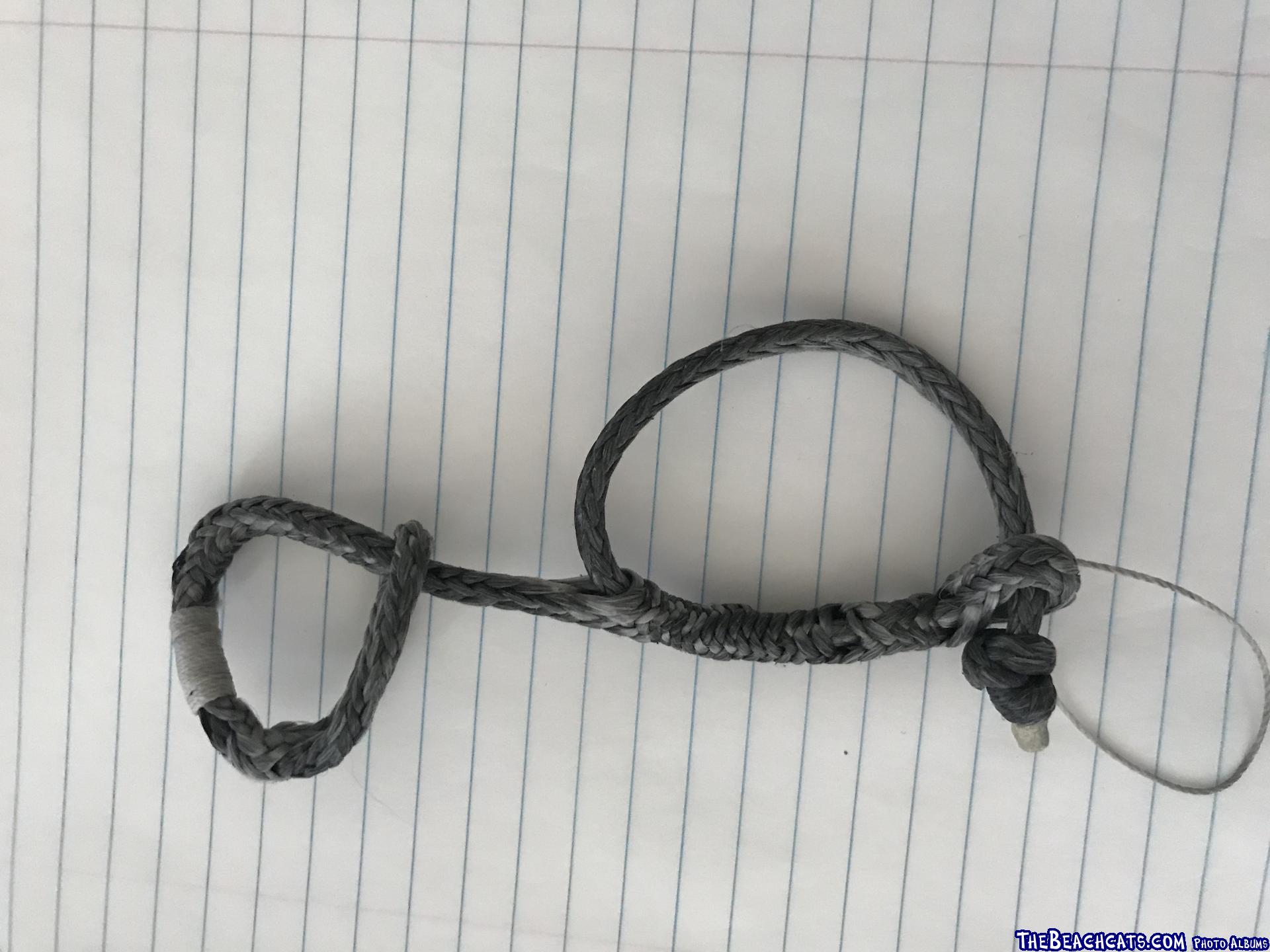

  • i use a soft shackle at the end of my jib sheet bridal to attach the blocks to the jib clew
    used it for 5 years at least
    it has never come loose
    https://www.thebeachcats.com/gallery2/main.php?g2_view=core.DownloadItem&g2_itemId=133336&g2_serialNumber=3
    Edited by MN3 on Jul 20, 2020 - 10:14 AM.

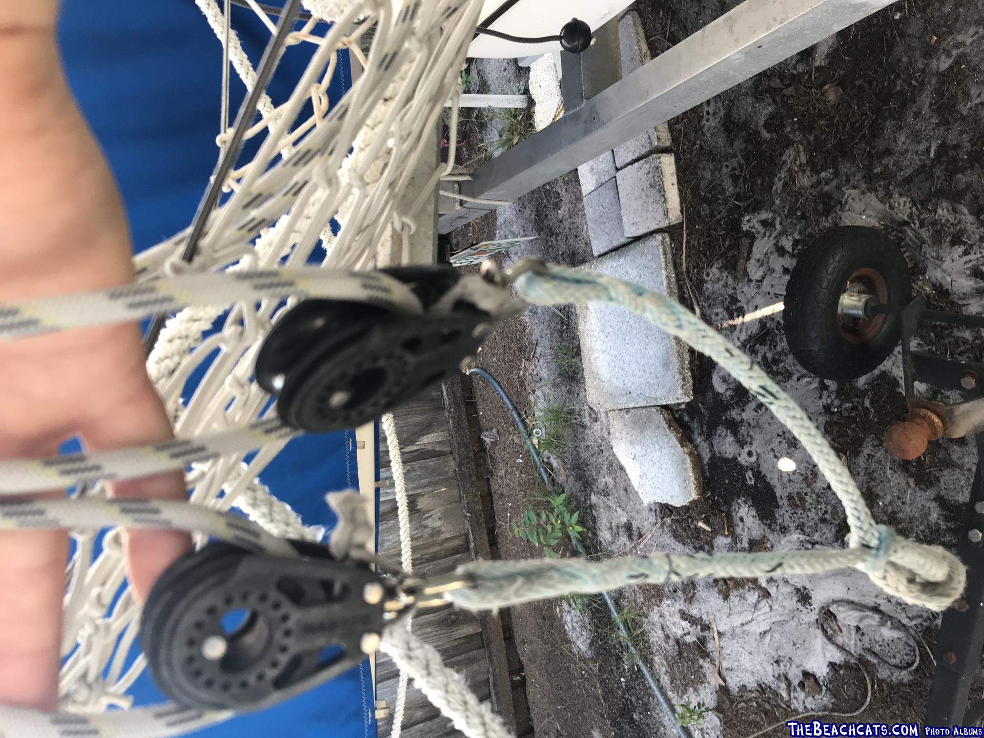

  • aquaaddictAre they a good choice for jib sheet? I am thinking being lightweight would help to not collapse the jib in very light air, but is there a risk of the lazy sheet coming off as not under load the pull the soft shackle taught? Any particular considerations when looking at making them for this purpose?
    I use them on any jibs that do not stay rigged all season. This one was from my 6.0XL Mystere, (20’ x 10’).
    I have used it on the Hobie 18, & even on my 15’ Dart. The Dart has a pretty small jib, I would make one out of smaller line.
    It takes no skill at making splices or loops, merely a few knots. You can see the jib blocks are secured by a knot. After hoisting the jib, simply slide the loop through the clew, then put the monkey fist into the loop. At the end of the day, it is taken off without untying anything, or requiring a shackle dog.
    I’ve used it for years, & it has never come undone.
    https://www.thebeachcats.com/pictures?g2_itemId=133337
    Sorry,mthesendamned ipads don’t give me a valid link to post the photo direct.
    Got a real computer...
    https://www.thebeachcats.com/gallery2/main.php?g2_view=core.DownloadItem&g2_itemId=133338&g2_serialNumber=4&g2_GALLERYSID=ce2011786049d910e0f69f8b5e6c4922
    Edited by Edchris177 on Jul 20, 2020 - 08:18 PM.
