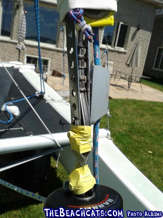

  • Many don't use a clam cleat at all. Their halyard comes down the mast & cleats. For years we just tensioned to take the wrinkles out & sailed.
    That said, I have the ability to tension on both the 5.7 & 5.0. However, this is easier if you have roller furling setup.
    Your jib halyard goes up the forestay, around the small block, then BACK DOWN THE FORESTAY, (inside the zipper that keeps the sail on the forestay. Now, just pull the desired tension & cleat. Make sure you have some sort of stopper knot so you don't lose the halyard end out of the cleat, or your tipping the boat retrieve it. You also need sister clips to remove the unused section of halyard once the jib is up.
    There are numerous ways to attach the tack. I use a small bit of Spyder Line. Nacra has an official tang that pins it, & I have used a small shackle. This is my current setup. It's the 5.7 but they are the same rigging.
    https://www.thebeachcats.com/gallery2/main.php?g2_view=core.DownloadItem&g2_itemId=103246&g2_serialNumber=6
