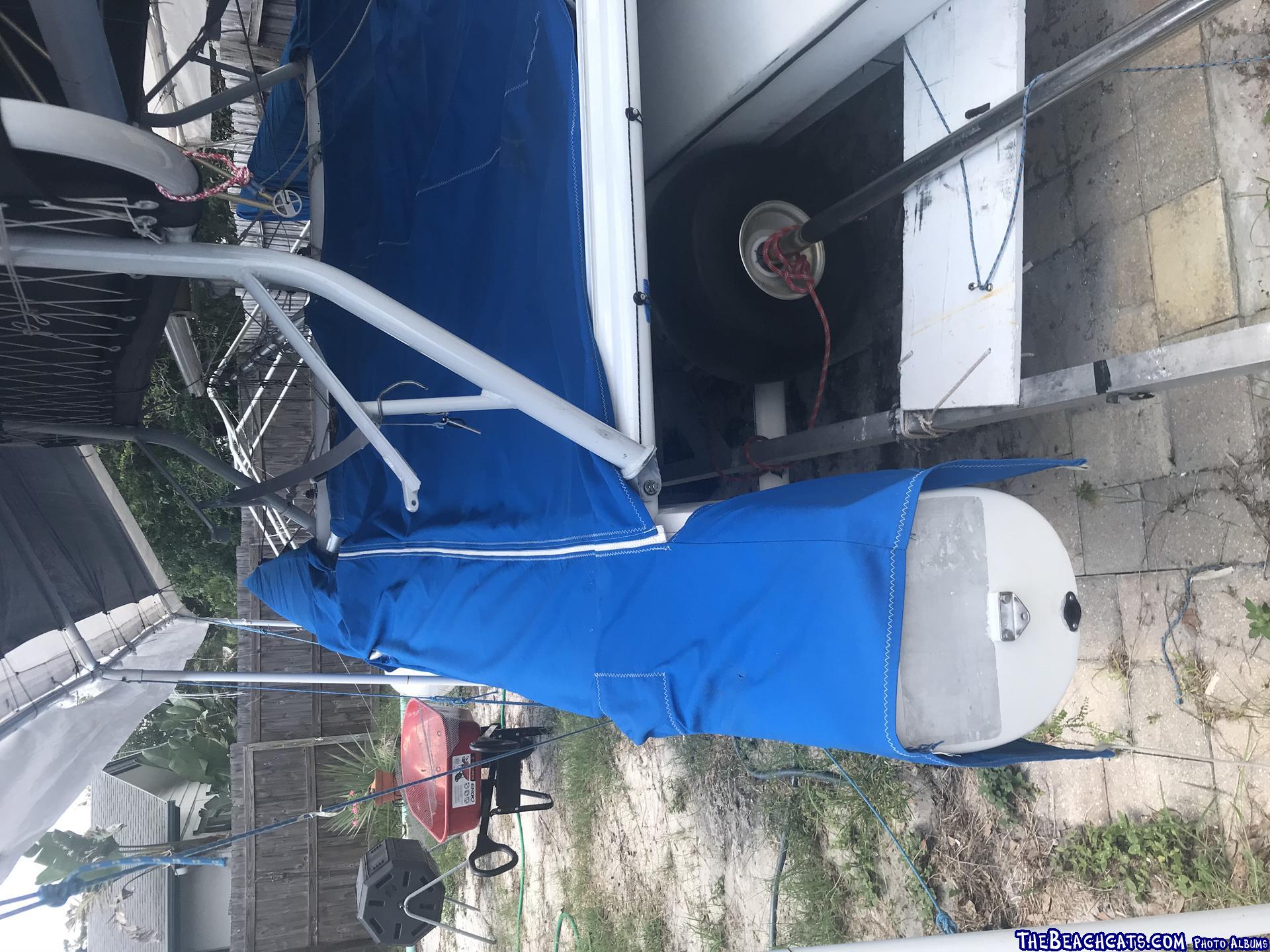

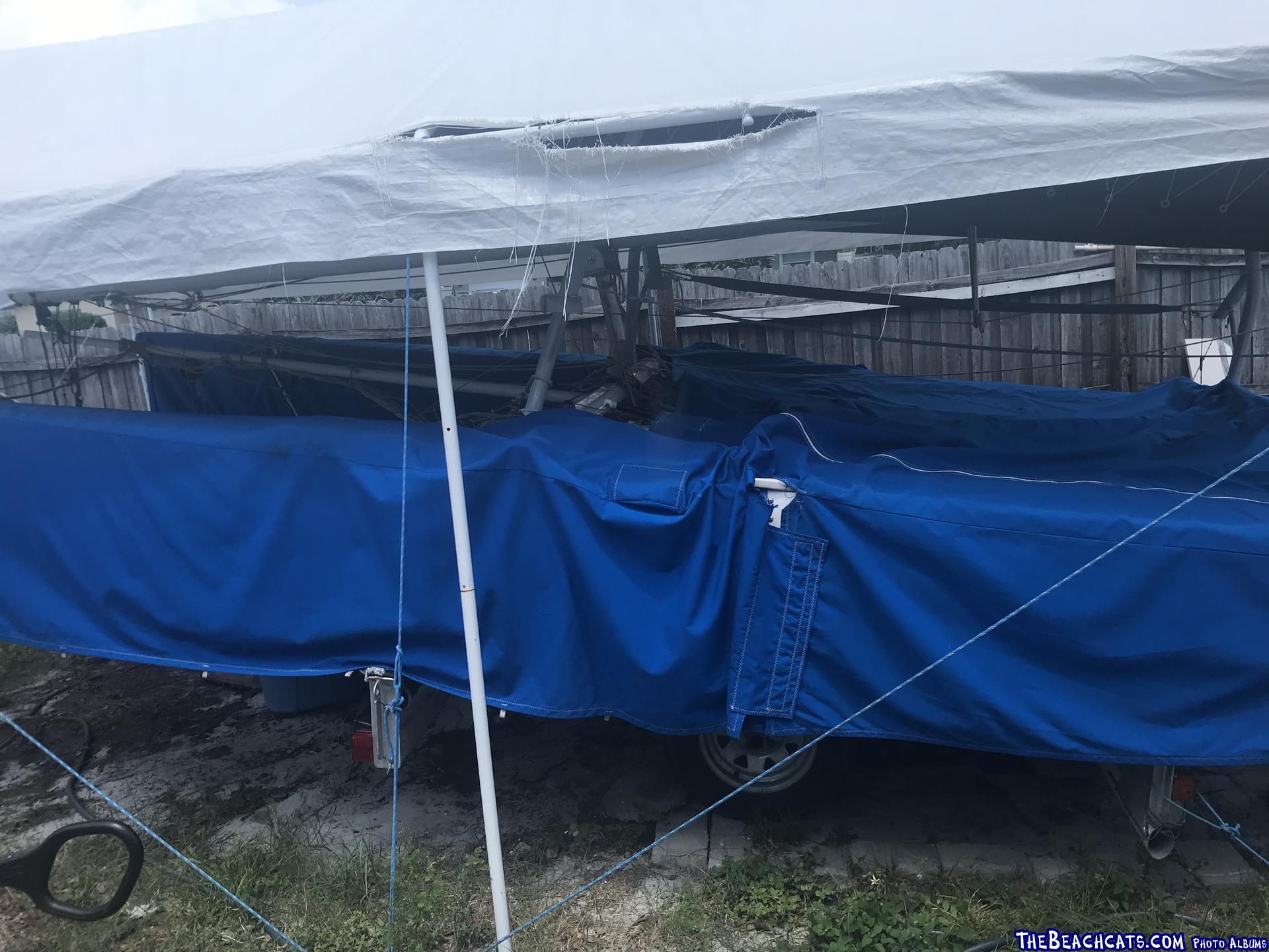

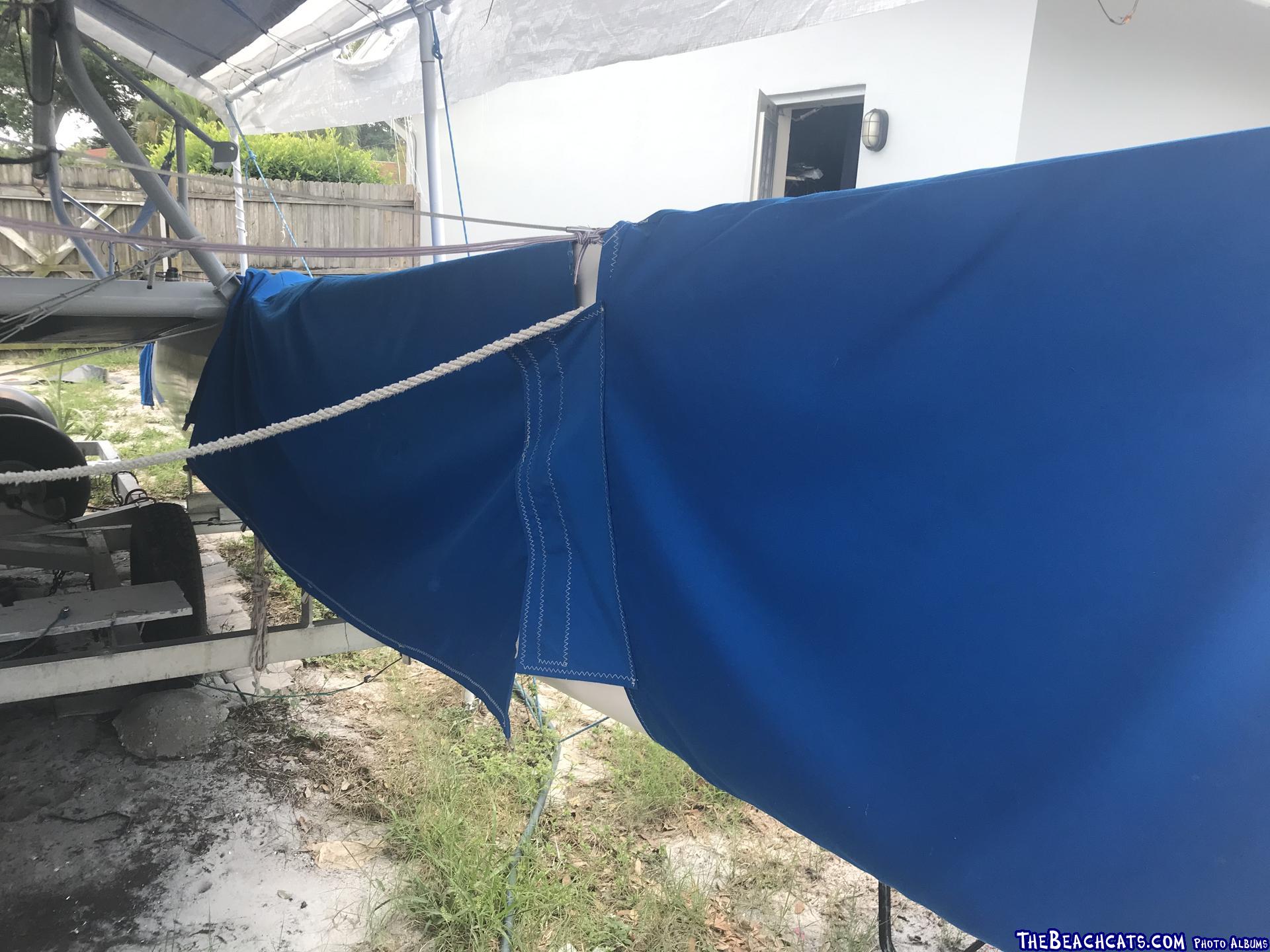

  • I have a cat cover for my 6.0
    it is currently on my 5.5 and a little oversized
    not sure where it was made and would probably be pricy new/custom but it's pretty sweet - or was in it's day
    (need some love)
    https://www.thebeachcats.com/gallery2/main.php?g2_view=core.DownloadItem&g2_itemId=133148&g2_serialNumber=3
    https://www.thebeachcats.com/gallery2/main.php?g2_view=core.DownloadItem&g2_itemId=133149&g2_serialNumber=3
    https://www.thebeachcats.com/gallery2/main.php?g2_view=core.DownloadItem&g2_itemId=133150&g2_serialNumber=3

  • MN3I have a cat cover for my 6.0
    (need some love)
    That's something like what I am aiming for, as long as it can be adapted for mast-up (openings in the appropriate places, etc). The one company I found that offers something like that is in Ohio, but I'm going to have to contact them to see if it will work since all their photos are with all lines, shrouds etc hidden and the mast down.

  • Quote as long as it can be adapted for mast-up (openings in the appropriate places, etc).
    this one has velcro closures at all 4 shroud locations so it can be put on or removed mast up or down

  • there is a reason sunbrella is used (and the industry leader) in most boat applications
    my cover is at least 15 years old - sat in a garage most of it's iife but that is a hard life in florida.
    you get what you pay for

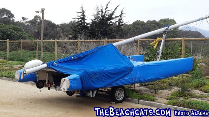

  • Here some pictures of my home made cover. I sew a new one every 2 or 3 years, I was normally using a reasonably cheap awning fabric. For the current one, that I made last februrary, I used UV resistant tarp, which was a bit cheaper and lighter. The white pieces on the stern were reused from the replaced cover because they were in good shape, it looks pretty cool also. The trampoline cover is a real one taken from a small yatch, I've got that one with the cat years ago. You can see that the tarp is stretched at the starboard hull above the front beam, this is because I made the whole piece too short this time, I used the old cover as template to cut the new one but something went wrong this time, ignore that detail... What I normally do is place the new fabric on the boat, fit it with masking tape and mark. You have to cut at the interferences (bridles, shrouds), cut along the beams the piece that will go above the trampoline, not all the way, only 40 cm or so, depending on the widht of the fabric. So the piece I get is the length of the boat + 1 mt more or so, which I cut in two pieces, one for each hull. The first part at the bow is a sleeve, I put that part first and then unroll towards the sterns, at the lower end of the rear part I put a sort small of batten each side that I clip together. For the cut under the bridle and under the shrouds I use SS turnbutton fasteners, very easy to install.
    https://www.thebeachcats.…ictures?g2_itemId=133151
    https://www.thebeachcats.com/gallery2/main.php?g2_view=core.DownloadItem&g2_itemId=133157&g2_serialNumber=4

  • AndinistaHere some pictures of my home made cover. I sew a new one every 2 or 3 years, I was normally using a reasonably cheap awning fabric. For the current one, that I made last februrary, I used UV resistant tarp, which was a bit cheaper and lighter. The white pieces on the stern were reused from the replaced cover because they were in good shape, it looks pretty cool also. The trampoline cover is a real one taken from a small yatch, I've got that one with the cat years ago. You can see that the tarp is stretched at the starboard hull above the front beam, this is because I made the whole piece too short this time, I used the old cover as template to cut the new one but something went wrong this time, ignore that detail... What I normally do is place the new fabric on the boat, fit it with masking tape and mark. You have to cut at the interferences (bridles, shrouds), cut along the beams the piece that will go above the trampoline, not all the way, only 40 cm or so, depending on the widht of the fabric. So the piece I get is the length of the boat + 1 mt more or so, which I cut in two pieces, one for each hull. The first part at the bow is a sleeve, I put that part first and then unroll towards the sterns, at the lower end of the rear part I put a sort small of batten each side that I clip together. For the cut under the bridle and under the shrouds I use SS turnbutton fasteners, very easy to install.
    Very helpful if I decide to go the DIY route! Nice work and a great explanation...
