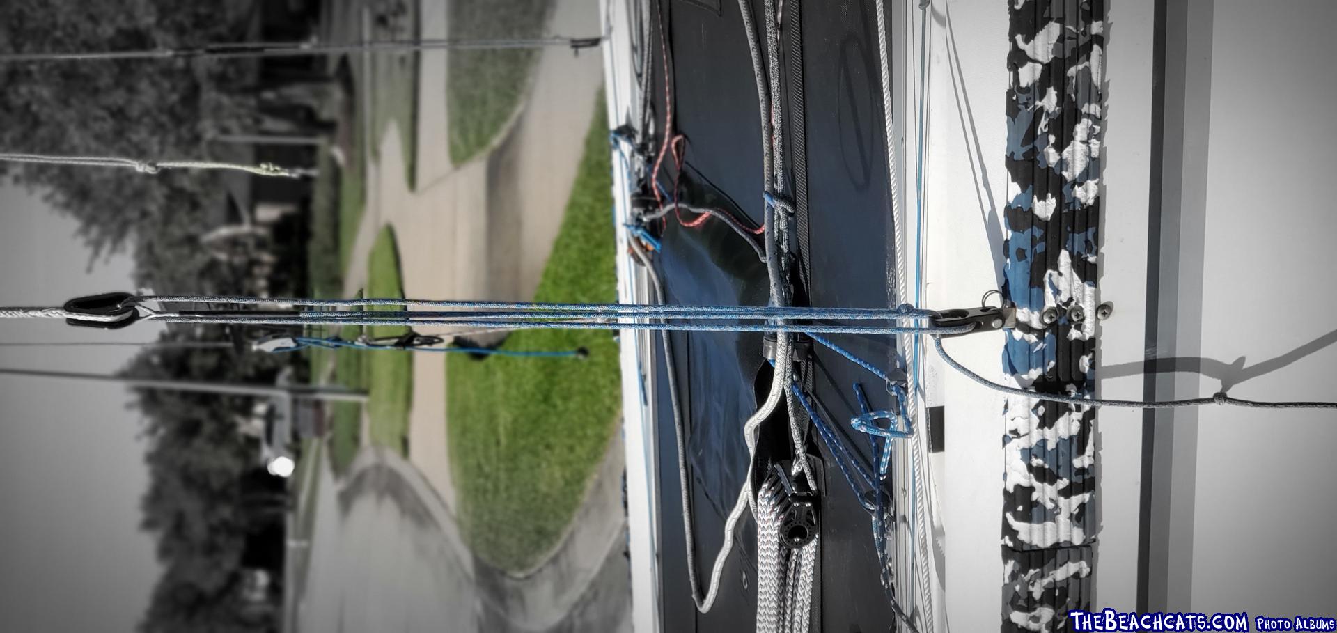

    Now for how u use this rig. As many of you know I'm mostly a single hand sailor, and as such I look for strength as well as ease of use. This rig uses a 3:1 lashing line with a stopper knot system to keep the rig under tension. Per the large loos gauge I am putting just short of 500lbs tension on the shrouds just by clipping in my harness and pulling the lashing line to the stops. Because of the extra length of the lashing line I am also able to lean the rig 15 to 20* forward for mast stepping as well as canting the rig for racing point to point racing on a single tack much like a wind surfer.

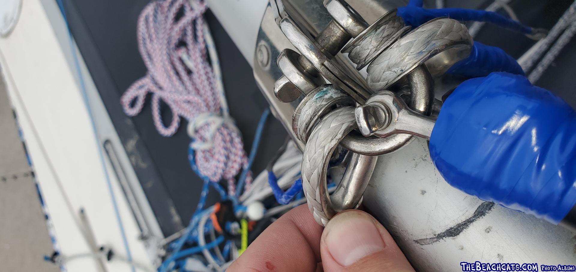

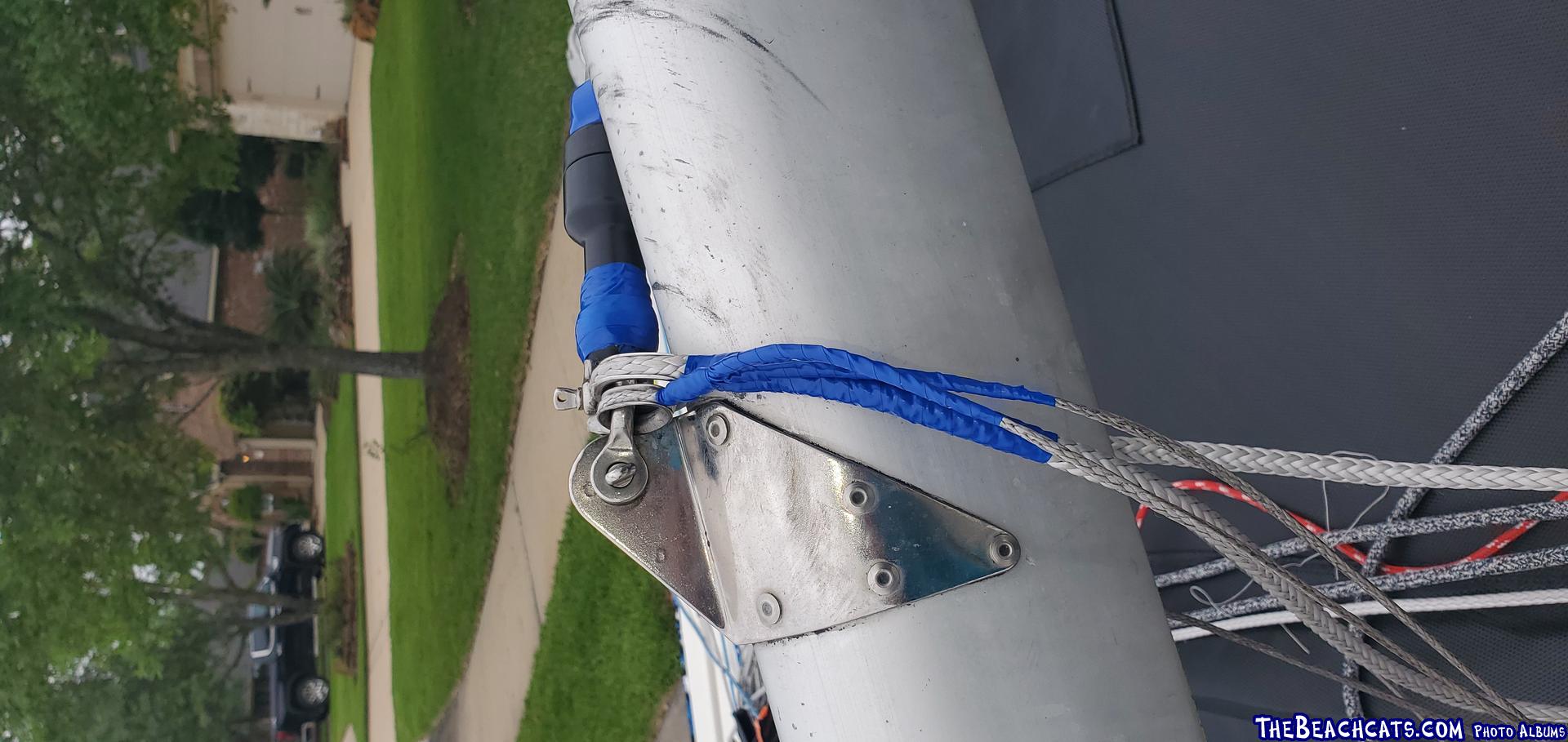

    Up top is the only place that I have found any sign of wear (minor fuzz), and that is where the shroud touches on the hound of the mast while trailering. I have fixed that by putting tape on the shroud where it hangs while trailering to provide some chafe coverage. There is also some minor wear on the sail maker thimbles that hold the shroud in the mast head shackle, but none on the actual shroud. I may press in a new thimble in the next year to give extra protection, but once again this is not a major issue and should last for years more even if I dont touch it. I also plan on putting a smaller hound about 6 inches above the main hound to move my trap wires higher and off the same shackle as the shrouds and eliminate a other possibility of wear
