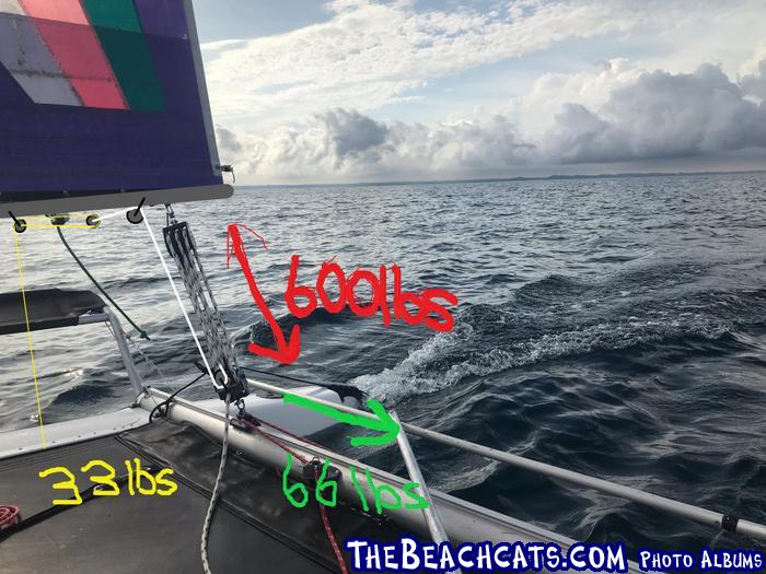

  • https://www.thebeachcats.com/gallery2/main.php?g2_view=core.DownloadItem&g2_itemId=132831&g2_serialNumber=4
    Because I'm too cheap to pay $600 for 12:1 main sheet blocks. Consider the pictures above and below. Pretend I add a pulley where the mainsheet currently ties off and go back to boom. That will turn my main sheet from 8:1 to 9:1. Then I take the end of that line and attach it to a pulley. That pulley is in turn its own 2:1 purchase system. Now I will have a 9:1 main sheet as well as a 18:1 Main sheet. (If I want 8:1 and 16:1 i can unthread one of the pulleys on the main blocks.) This will give me an optional fine adjust main that I should be able to trim with one hand.

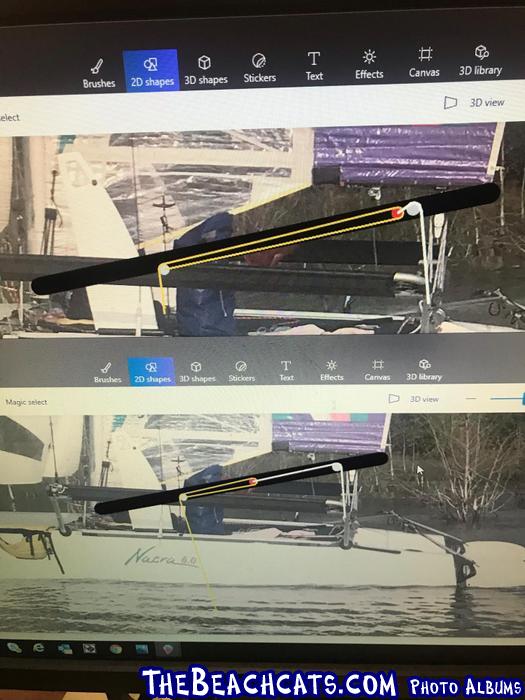

    Here's my favorite part:
    https://www.thebeachcats.com/gallery2/main.php?g2_view=core.DownloadItem&g2_itemId=132843&g2_serialNumber=4
    In the picture above, the grey pulleys are fixed while the red pulley moves. The grey pulleys are about 4 ft apart. When the fine adjust isn't in use the red pulley is allowed all the way to the back of the boom until it butts up to the rear fixed pulley at this point a 1ft tag line is dangling from boom. When the crew decides to take the main trimming for say double trapping he/she grabs the tag line and pulls it 4 ft out to the edge of the boat and the red pulley is now in its intermediate position.
    What do you think?

  • Very smart solution. It's hard to if some details may fail, I see a few things to have in mind
    - The forces may be very high, be careful at the attachments at the boom.
    - If you are using the yellow line from the helm, it seems that the force might tend to pull the boom out of the gooseneck
    - A 18:1 system will mean a lot of rope to produce limited effect on the sail, the fine tuning might end up too fine for what you are looking for. Or could be too slow or too short for avoiding a capsize.

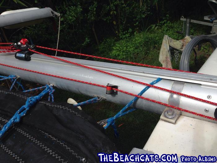

    - I made this invention to be able to lock the traveler in position:
    https://www.thebeachcats.com/gallery2/main.php?g2_view=core.DownloadItem&g2_itemId=112853&g2_serialNumber=4
    At each side of the rear beam there is an eyestrap in the back, where that red line starts and a block in the front for the same line. I added two blocks at each side of the traveler for the rope and two cleats like the one with the red part (the other one is green and opposite). End result is something that works but that I almost never use. I mostly keep the traveler centered, and if it's blowing to hard, bothering on this littke cleat is not a very good idea. On longer runs I occasionally use it but not very often.
  • Yes 18:1 might be too much. I'll have to play with it. as for the force on the gooseneck, as long as the trimmer is pulling perpendicular to the boom the net fore/aft force should be zero. the tension should all be between the two grey pulleys. Now if the helmsman is all the way at the back of the boat and pulling onthe fine tune it would yield some force away from the mast. not enough to overcome the force of the 8:1 on the boom. The existing 8:1 would be mounted behind the rear cross bar on the boom like new cats do.
    I thought about that double cleating system on the traveler like a keel boat would have. Looks neat in your application. Doesn't that make it non self tacking though? Nice Boat!
