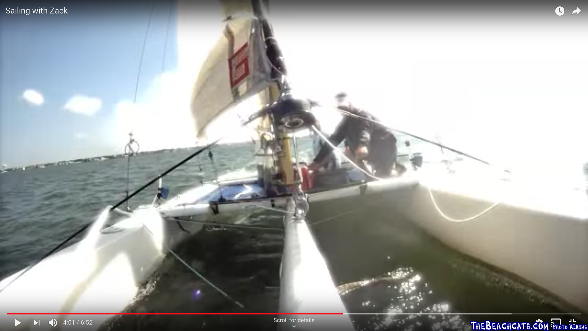

  • QuoteI wonder exactly how the geometry on the 5.5 was setup.
    here is a video of the boat under sail - lots of shots of the setup -
    https://www.youtube.com/watch?v=6UGtFkCsSiY&t=246s
    i do now see (now that i'm looking) the luff looks way to loose and i'm pretty sure that capricorn jib wasn't cut with a furler in mind
    at 3:30 you can see me need to loosen the sheet to get the sail to tack
    be sure to check out the rattlesnake we turn around and sail directly over at 4:01 :)
