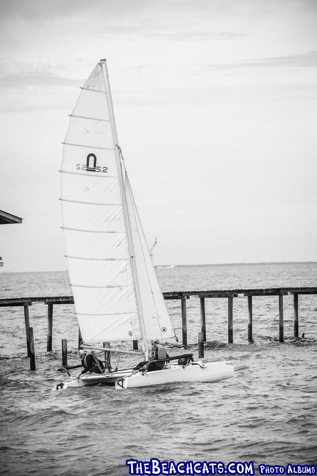

  • Its a 5.2 boom alright. Looks just like everyone I have ever seen pictured. I am not too worried about it now. My bolt rope might have shrunk causing the luff to be short under light tension. This makes the tack way shy of the gooseneck causing the boom to be high and seemingly too short.

    Found a picture. Based on the luff crinkles I think I need to tension up the cunningham.

    QuoteThis makes the tack way shy of the gooseneck causing the boom to be high and seemingly too short.
    unless 5.2's have a floating gooseneck that isn't attached to the mast - your tack doesn't have any effect on your boom height (this is set by your gooseneck location)- you clew could effect the angle (height) of your boom, but your mast rake would too.

    That's not terrible. Easy fix. Lay the sail out on the ground. At the tack, bottom of the bolt rope, there will be some heavy stitching holding the bolt rope in place. Cut this stitching loose and pull the threads out. The bolt rope will slide up the luff. Put the sail up and tighten the downhaul. This will pull the shrunken bolt rope up and eliminate most of the wrinkles. For ideal shape, take pictures from the boom up the sail. Start with no downhaul and mark on the mast each inch as you pull the downhaul. Take a picture at each mark. You can then take the pictures on the computer and compare the draft. You will find that your max draft will be about 25% downhaul tension. The benefit of this is two fold: you know where your max draft is and you can see how much the sail flattens out with max downhaul. As the wind builds, pull downhaul to flatten the mainsail. This will help keep the boat "on it's feet". On the 5.2, you know you have too much downhaul tension when you get a funky inversion bend from the tack to the batten just below the logo. We used to run a 24:1 downhaul system.

    I am talking about the end of boom elevation. I have seen many photos where the 5.2 foot is close to the boom. I have a big enough gap to jump through.
