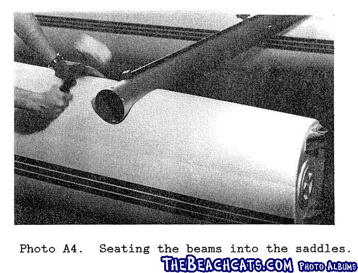

    Those are factory installed, don't ask me why they put them there, but the SuperCats all come with them. I just found out that the brains behind SC passed away last April

    This is from the owner manual;
    https://www.thebeachcats.com/gallery2/main.php?g2_view=core.DownloadItem&g2_itemId=132003&g2_serialNumber=4
    Edited by Edchris177 on Aug 07, 2019 - 09:17 AM.
