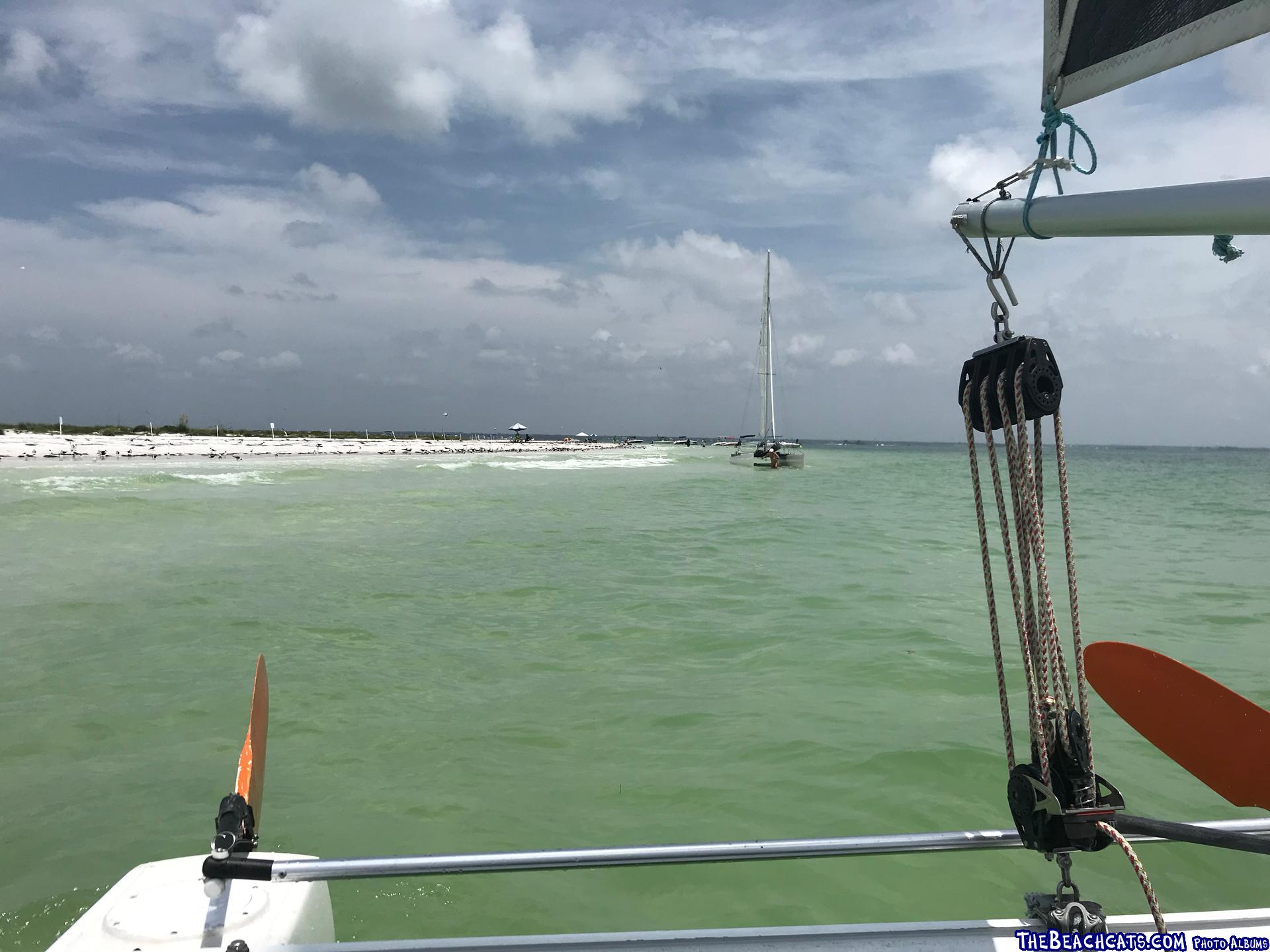

    my current setup
    https://www.thebeachcats.com/gallery2/main.php?g2_view=core.DownloadItem&g2_itemId=131807&g2_serialNumber=3
