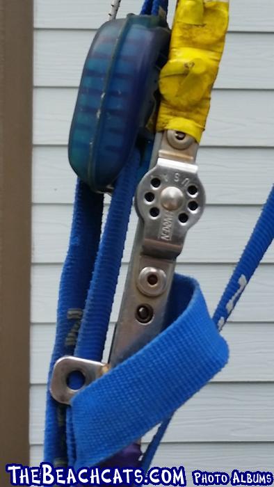

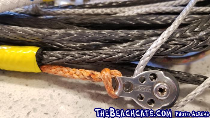

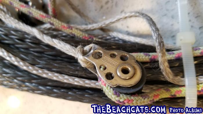

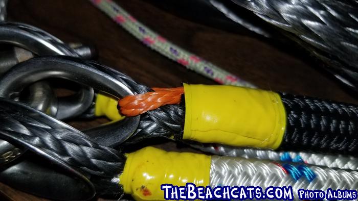

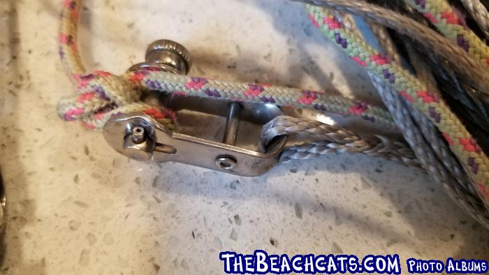

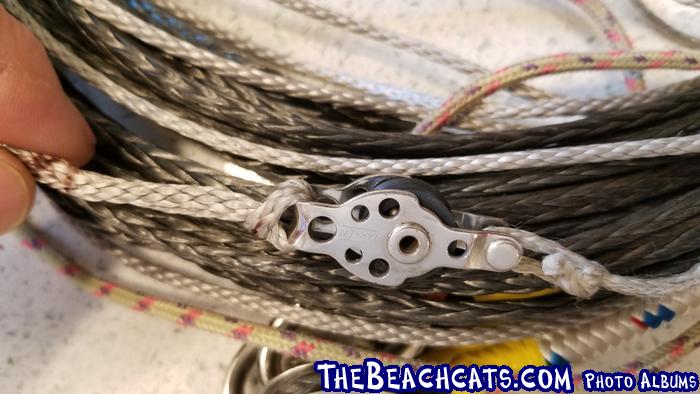

  • This is going to be harder to visualize than expected . . .
    A couple of notes. All the rigging is synthetic. Most of the downhaul set up is inside the zippered jib luff. Jib downhaul is 6:1. The conventional forestay jib pigtail was done away with.
    I can tell you that jib downhaul is very effective, especially when racing. It light winds it is a game changer for me. When it's honkin' I run it flat upwind and drop the jib traveler until the inside telltales are on the edge of breaking. Downwind full draft. You can see a big difference between a flat jib and one full of draft based on the downhaul setting.
    I created an album with details. If you look at the root album description in the first link the details will be truncated. Click on the image to get the entire description details. Click on the image a second time and it will SUPERSIZE.

    This one's for you Pete, since you asked!
