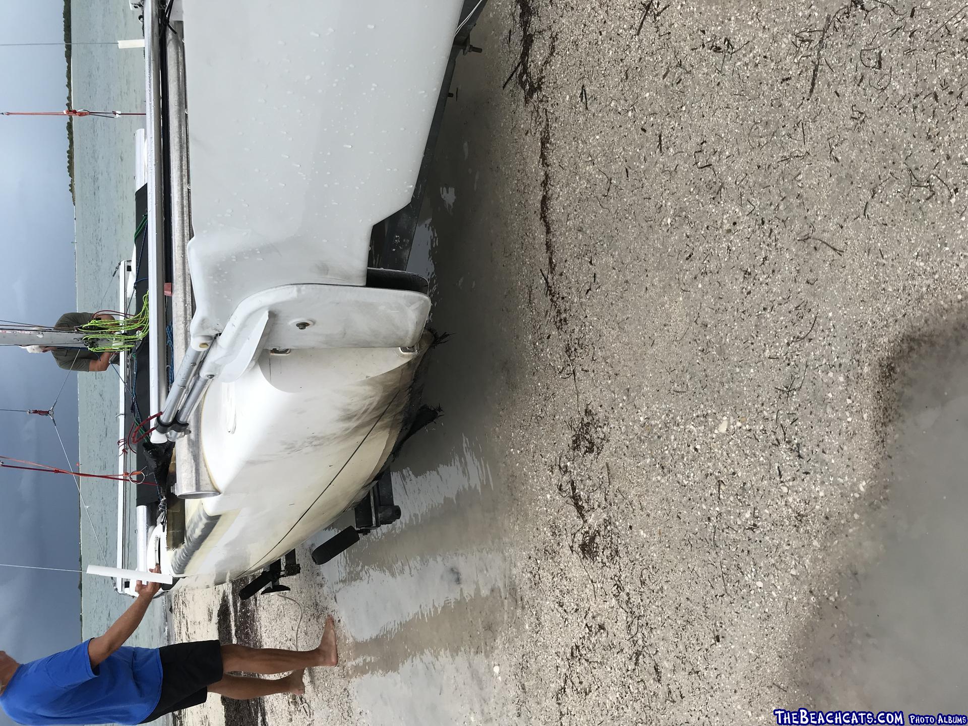

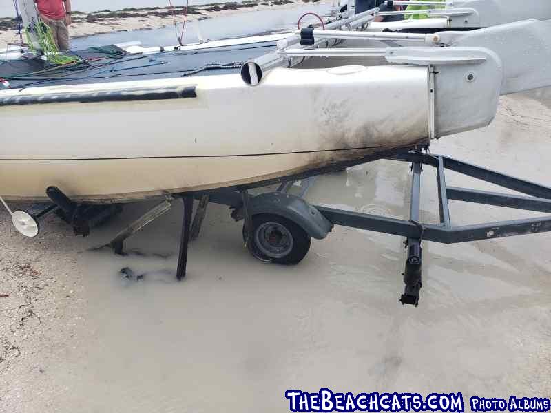

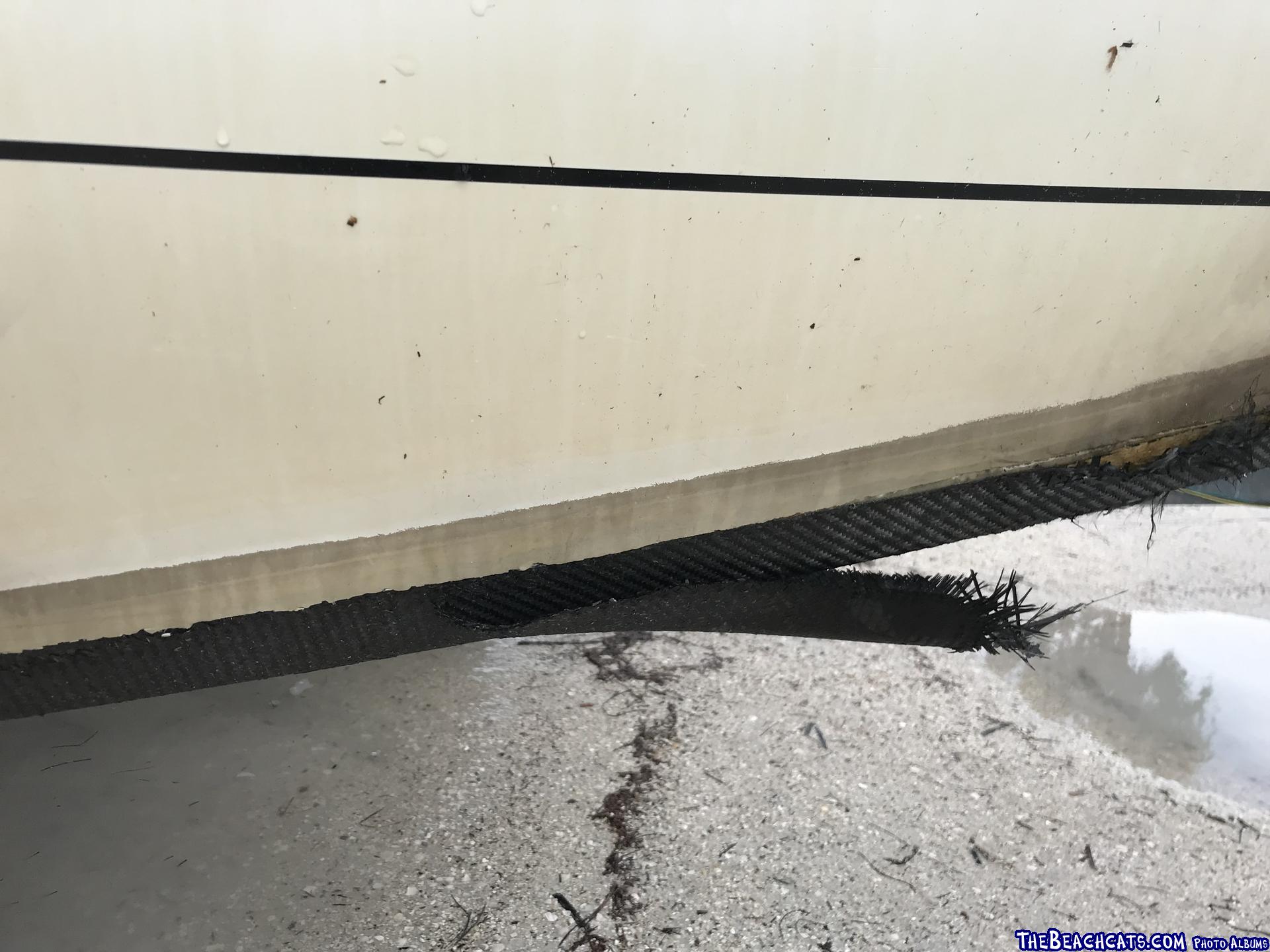

    my friend Ron wasn't so lucky this weekend
    his f16/g-cat turbo was "destroyed" (he is a retired composite engineer so he may be able to rebuild this - but most would call it a total loss)
    https://www.thebeachcats.com/gallery2/main.php?g2_view=core.DownloadItem&g2_itemId=131574&g2_serialNumber=3
    https://www.thebeachcats.com/gallery2/main.php?g2_view=core.DownloadItem&g2_itemId=131575&g2_serialNumber=3
    https://www.thebeachcats.com/gallery2/main.php?g2_view=core.DownloadItem&g2_itemId=131576&g2_serialNumber=3
    https://www.thebeachcats.com/gallery2/main.php?g2_view=core.DownloadItem&g2_itemId=131577&g2_serialNumber=10
    All the carbon fiber he put on the boat caught fire and or melted
