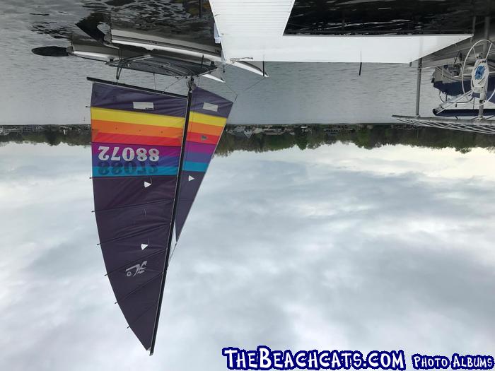

  • I bought another boat. A 86' Hobie 16. I bought it as something I can easily drag up and down the beach myself as well as race locally with clubs like CRAM. The boat is great. I've never sailed a hobie 16 though and now after a couple sails I have some questions.

    I have a comp tip. I haven't been able to fully raise the main. Do I need to be pulling forward on the halyard towards the bow to get around main hook?

  • Sounds like getting the main up is your only slow down. Everything else is normal and doesn’t need attention to get on the water. How far does your main get? Are you a few inches short or a few feet? Does it get progressively harder or just abruptly stop? Lots of good sailing lakes in Indiana, best thing to do is find another 16 sailor, or better yet a club

    Quote How far does your main get?
    See picture. Almost all the way.
