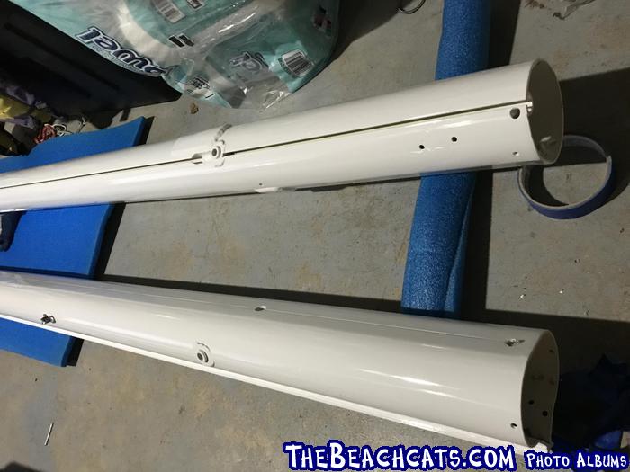

I just got both my beams painted by Brian's company (yacht riggers works with a pro painter)
around 200 each - not including prep
i painted zack's old 5.5 beams before i sold it with automotive rustolium (or similar, can't recall)

I have a 33gal compressor, decent gun, water separators and PPE. As for the paint booth, I know a garage tarped in plastic isn't ideal, but better than outside for conditions. So it's conceivable as a DYI'er. Your beams look way nice and maybe I'll break down and spend the dough. Just seems like every time I turn around it's some other unexpected larger ticket item...iphone died the other day, radiator on my truck is going, oh and I'm having a kid now. Come to find out babies are expensive. Who knew.
I may go the Catman route. Application guides indicate you can shoot their marine topside product reduced with xylene at 15%. Just can't find anything on the webs indicating if you can clear over it.

yea i realized at lunch that you had been shooting gel-coat and had a set up
If you have a wind proof garage - you can set up a few giant fans to control air flow you should be fine
And the more i thought about it - catman just re-did his 6.0 and his beams were recently repaired by Brian too - so he must have painted them . he is probably your best resource for info or even the work
I know catman clear coated his original job (over rust-o-lium) a decade ago or so ... but as i said the have changed the composition of paints ... and i don't talk with him anymo' so i don;'t know if he clear-coated this time too (or what paint he shot this time)
