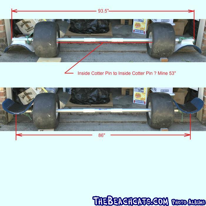

  • So the planets aligned and I came across a set of "real" Cat Trax locally at a "reasonable" price (very rare in my parts). Everything looks great except the fit. The hull cradles appear to be of the larger type which is no problem although I would prefer the smaller cradles as they fit better and provide a little more stability as in no waddle when moving the boat. The cradles are centered on 86" and my 5.0 hulls center on 84" so my thought was to move the cradles in an inch on each side. Doing some detailed inspection and measuring I find that if I move the cradles in an inch they will interfere with the tires. This seemed very odd relative to other sets of Cat Trax I've owned over the years so I did some more measuring.
    The axle is 93.5" (7' 9") in length which is very odd as FS only sells them in nominal 7 or 8 ft. and up. This may account for the tire/cradle interference as they drill at standard dimensions from the end of the axle to get the proper cotter pin separation for the wheel.
    The next thing that seems odd is the dimension between the wheels. From inside cotter pin to inside cotter pin mine measures 53". Could someone please check this dimension for me on an 8' axle version. I was expecting about 51.25" based on what I've seen in the past.

  • you can always move the tires more towards the center. I've had to do that before. The bearings are held in place by big plastic disks and cotter pins, just reposition them.

  • my first set of wheels was for my h18
    after i purchased my next boat (m5.5) the wheels didn't fit
    we simply cut the tube, added a slightly larger sleeve over it and attached w bolts. problem solved, lasted for years until i sold them (second set came with new boat)
    as mentioned above, you could simply drill a few holes for new location of wheel cotter pins if needed

  • Thanks for the input lakewateree and MN3. Yes, I can re-drill the axle and make it all fit perfectly. Just wondering why the odd length axle and wheel spacing. Unfortunately I didn't get to speak to the original owner so I have no idea what they were setup for.

  • The OEM instructions are not much help, but this is all I got with the set I bought for the 5.7.
    https://static.hobiecat.c…_attachments/1626z52.pdf As mentioned, moving the wheel position is pretty easy if you drill straight.
