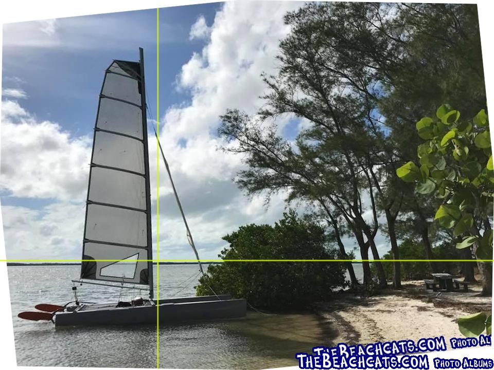

    this is my 6.0 with 5.5 main/jib last week. it was blowing 15-28 knots (i am also raked well forward to depower)
    It sailed very well and manageable in 20+ (solo)

  • Quoteraked well forward to depower
    Never heard this... please elaborate. Always heard forward in light air, back in heavy.
  • Raked forward to depower? Yea, that certainly runs contrary to the conventional wisdom of raking back to depower. Maybe he needs to do this to balance the helm with the smaller sail. Sure doesn’t look right to me....

    I question raking forward also - would like to hear more on that argument.

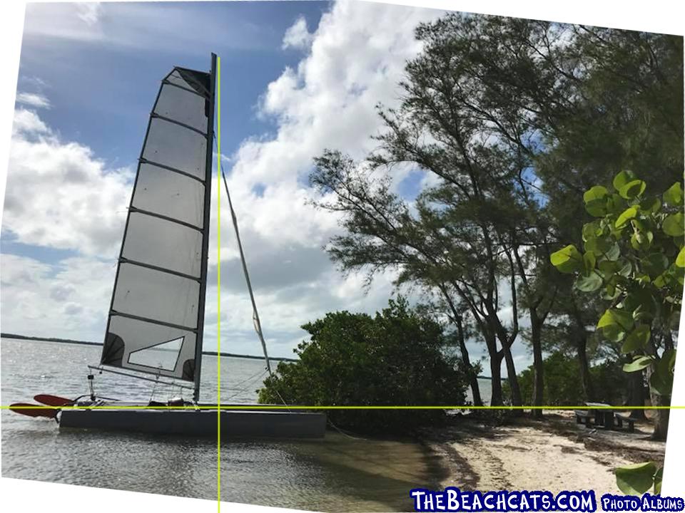

  • QuoteRaked forward to depower? Yea, that certainly runs contrary to the conventional wisdom of raking back to depower. Maybe he needs to do this to balance the helm with the smaller sail. Sure doesn’t look right to me....
    Thanks for keeping me honest
    i meant raked forward due to smaller sailplan (not wrestling with the tiller in 25 is a good thing)
    that picture is misleading ... the horizon on the water is sloped
    Here is a true version of my rake
    https://www.thebeachcats.com/gallery2/main.php?g2_view=core.DownloadItem&g2_itemId=130578&g2_serialNumber=3
    https://www.thebeachcats.com/gallery2/main.php?g2_view=core.DownloadItem&g2_itemId=130582&g2_serialNumber=3
    Edited by MN3 on Nov 06, 2018 - 07:46 PM.

  • If that's what it takes to balance the helm, I think I'd rather run the full sail plan with the mast raked back where it should be than use a smaller sail with the mast raked forward like that. Looks totally out of whack to me. I've never seen any cat rigged with the mast raked forward of plumb.
    Maybe pulling the centerboards up partially will help move the CLR aft and allow the mast to be raked back where it should be. Or rake the rudders forward slightly.
  • DogboyIf that's what it takes to balance the helm, I think I'd rather run the full sail plan with the mast raked back where it should be than use a smaller sail with the mast raked forward like that. Looks totally out of whack to me. I've never seen any cat rigged with the mast raked forward of plumb.
    you are probably correct - to be honest i didn't realize it was raked this far forward until i saw this pic - and i did swap out shroud adjusters early this season with a different type adjuster - a little difference can make for a big adjustment 31' aloft
    i will experiment in some lighter air
