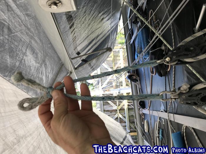

  • it's SOOOOoooo easy to make a soft shackle though...
    https://newcontent.westmarine.com/content/images/catalog/large/12501904.jpg
    no splice needed - just tie an eye/loop
    no high modulious needed - almost anyline will work .. but HM like will LAST
    I was recently thinking my 7 year old dyneema jib tack/furler soft shackle should get replaced ... kinda soon ...

  • Do I pull that eye through my clew and the eyes on my sheet blocks and then over that knot on the end and pull it tight?

  • gahambyDo I pull that eye through my clew and the eyes on my sheet blocks and then over that knot on the end and pull it tight?
    use this anywhere you would use a regular shackle (although i wouldn't use it on a place that is constantly loading and unloading ... i think it COULD come free)
    just "hook" it around whatever you want and lock it by pushing the ball through the eye
    that's it - no need to pull it tight
    https://www.thebeachcats.com/gallery2/main.php?g2_view=core.DownloadItem&g2_itemId=130020&g2_serialNumber=4
