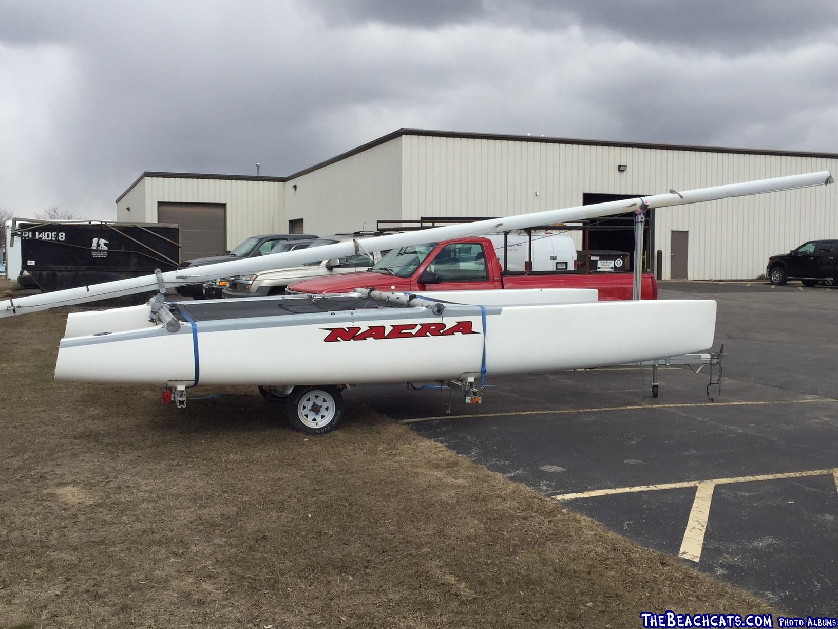

    Pic of my boat below
    https://www.thebeachcats.com/gallery2/main.php?g2_view=core.DownloadItem&g2_itemId=129776&g2_serialNumber=3
