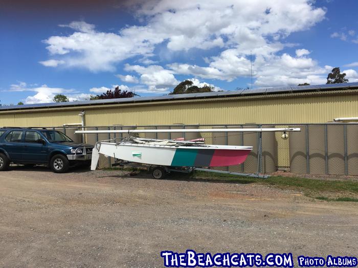

    Here is where it sat for almost a year
    https://www.thebeachcats.com/gallery2/main.php?g2_view=core.DownloadItem&g2_itemId=129245&g2_serialNumber=4

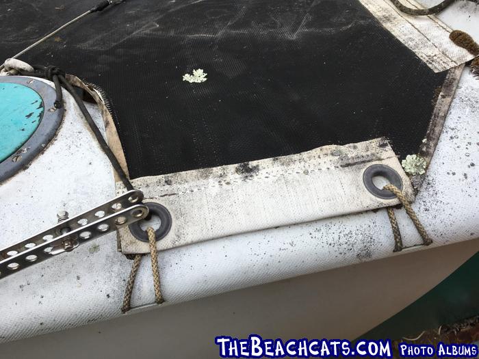

    Close up of the general condition
    https://www.thebeachcats.com/gallery2/main.php?g2_view=core.DownloadItem&g2_itemId=129250&g2_serialNumber=4

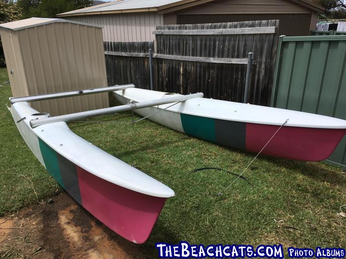

    After being stripped and lightly cleaned with a pressure washer
    https://www.thebeachcats.com/gallery2/main.php?g2_view=core.DownloadItem&g2_itemId=129262&g2_serialNumber=4
