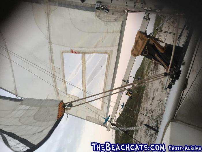

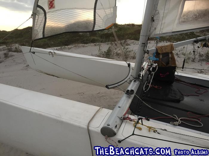

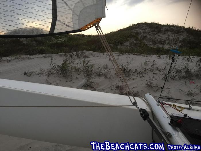

    Since the last time I wrote I have taken the catamaran out twice. I figured out a way to rig the automatic jib such that i only have to adjust one line from the trampoline. It basically weaves from the jib sheet to a pulley on the automatic jib rail, then to a pully that i put between the two hulls and back to a fairlead at the trampoline. The pictures do a better job of explaining.
    https://www.thebeachcats.com/gallery2/main.php?g2_view=core.DownloadItem&g2_itemId=129361&g2_serialNumber=4
    https://www.thebeachcats.com/gallery2/main.php?g2_view=core.DownloadItem&g2_itemId=129367&g2_serialNumber=4
    https://www.thebeachcats.com/gallery2/main.php?g2_view=core.DownloadItem&g2_itemId=129364&g2_serialNumber=4

  • This setup worked great and did not bind up any time. This was especially helpful since i solo this cat. I realize that the jib is "smaller" but it still measures six foot at the bottom and very fast anyway. So for me, i do not think an %120 or %150 sail would be better since i would have more adjustments on the trampoline and more power that is not needed. icon_cool

  • The way you have the jib sheet running forward to your lower jib bridle doesn’t look like it works very well. When you tension your jib sheet, you are inadvertently pulling the jib tack aft which is changing the profile at the bottom of the jib. Usually a setup like this is done in conjunction with having a spinnaker pole installed. The spinnaker pole holds the jib tack in position and provides compressive resistance against the portion of the jib sheet which runs forward/aft.
