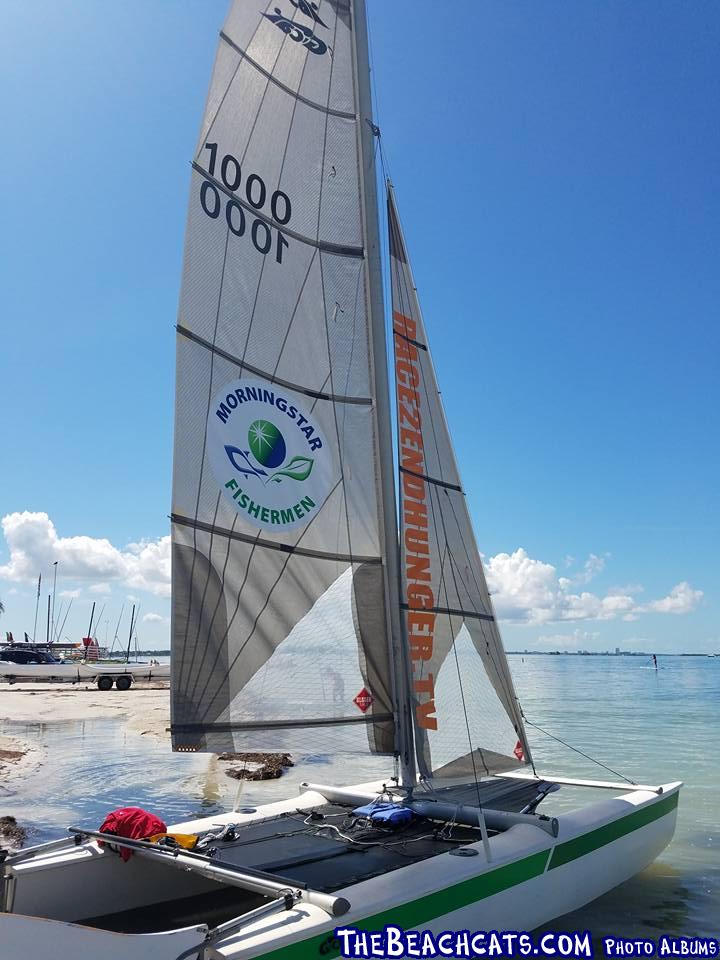

  • rockypointbobI recently purchased an 81 GCat 5.0 but she's needing a lot of TLC. Already received lots of good advice from this forum.
    Anyone have some pics of the jib and main sheet (no boom) rigging? I'm going to have to replace it all and while I could probably figure it out eventually, it would be great to have some pics to go by.
    If you need rigging specs, pm me...I have OEM specs for all standing and running rigging. .. length, size, etc....to my knowledge, it is not available anywhere publicly.

  • Newb here, also curious about the jib system for a G-Cat 5.0
    Can someone help me understand what the blue line is and how to utilize it?
    https://www.thebeachcats.com/gallery2/main.php?g2_view=core.DownloadItem&g2_itemId=128882&g2_serialNumber=3

    QuoteCan someone help me understand what the blue line is and how to utilize it?
    The blue line is one type of in / outhaul system (looks like the setup used in the manual - or damn close)
    this is used to change the position of the jib block and optimize windflow over your sails and increase speed/fun - (can also be used to depower when there is too much "fun" (wind) )
    IN GENERAL: ceteris paribus ...
    Upwind - you want the jib blocks "more" in-board
    and in light wind and waves - forward
    Downwind - you want the blocks "more" out-board
    and some times forward
    by pulling the bitter end (the end of the line) and cleating it you will change the position of the jib blocks, in or out. There is no forward or aft "feature" with this setup - and people looking for more options may add another dedicated system (forward, on or near the front beam) -

    This is the stock/original jib setup on the GCat 5.0. In the manual (both the written one and the diagram), the blue line is referred to as the barberhauler. As my nemesis said, let out down wind, and pull in when sailing up wind.
