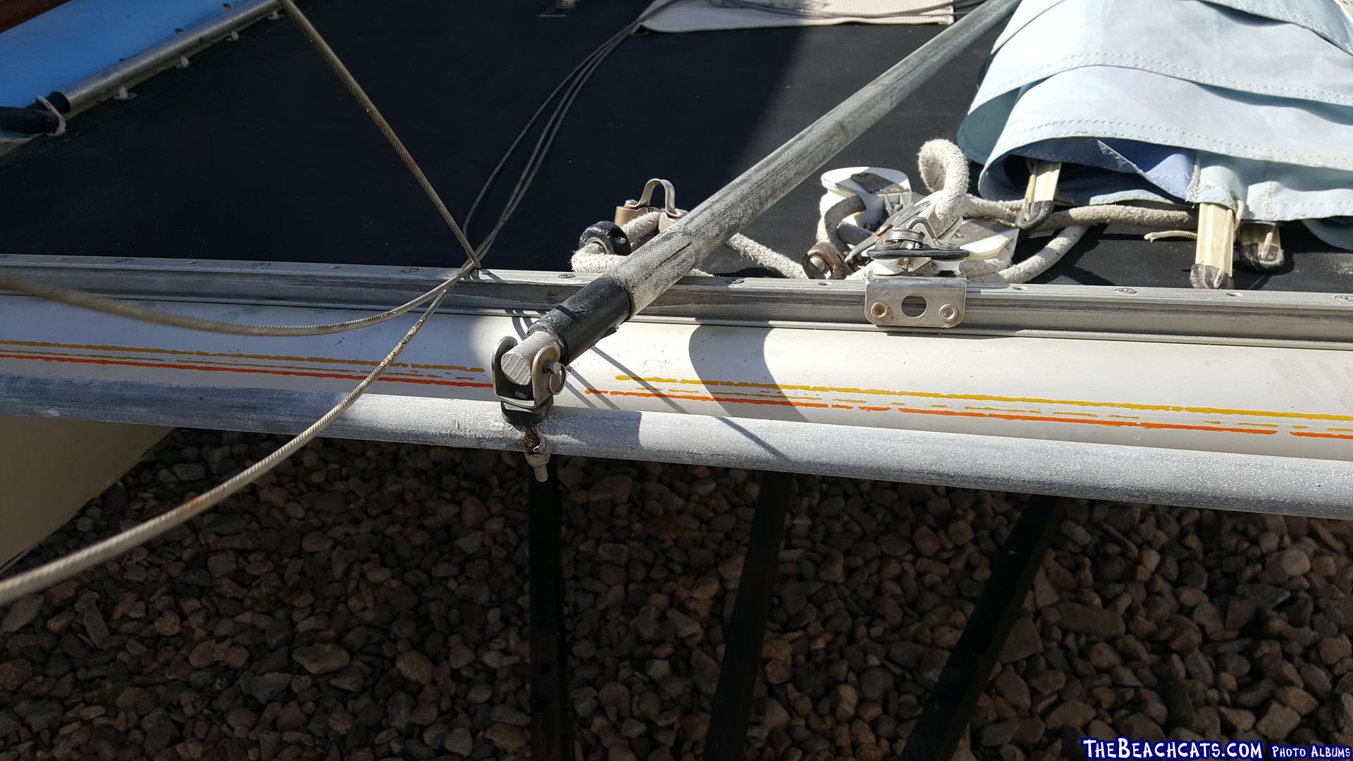

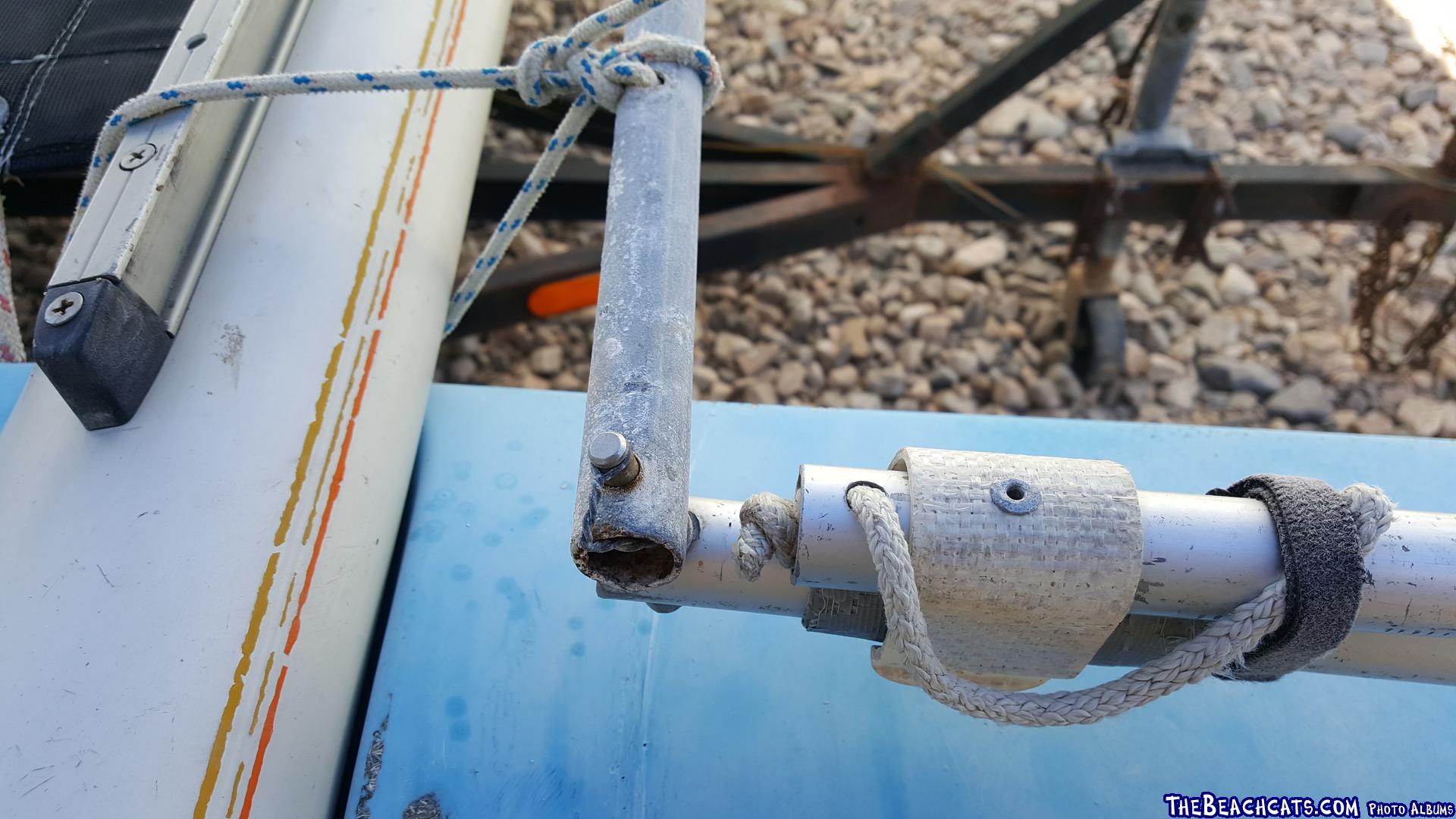

  • My first post and already great feedback; thank you! Still learning terminology. So when I say tiller, I do mean the entire tubing assembly that moves the rudders. The boat is old so I just want to ensure it is safe and reliable for just cruising around. I have several pics I will post as soon as I figure out how icon_rolleyes

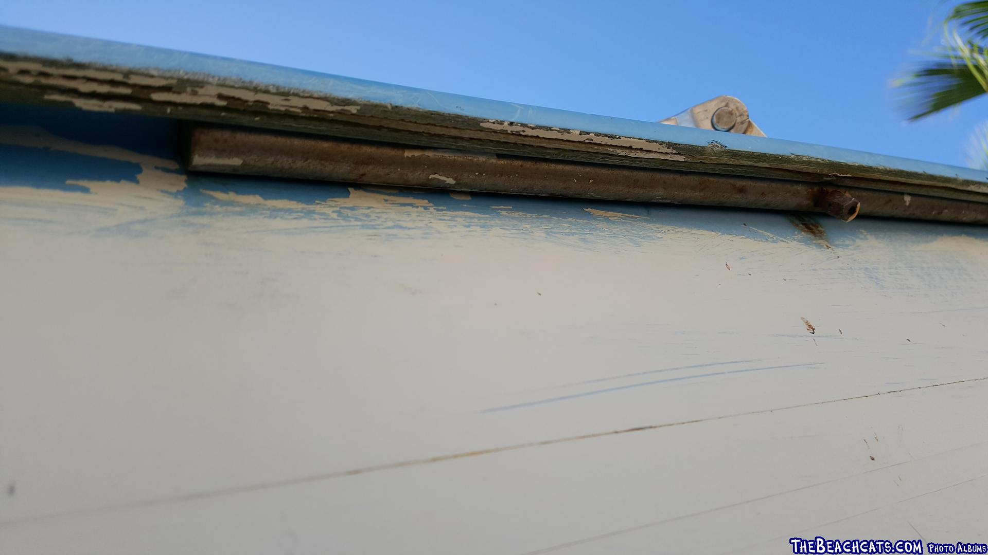

    But based on traphappy's comment, I'm a little concerned. I do have one pic that shows what I believe to be the hull-to-deck joint. Got a guy refinishing the hulls and they generally look ok. Faded but no soft spots....I'll double check the joint when I head back down to Mexico this weekend.

  • Deck-to-hull joint
    https://www.thebeachcats.com/pictures?g2_itemId=128655

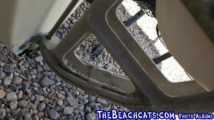

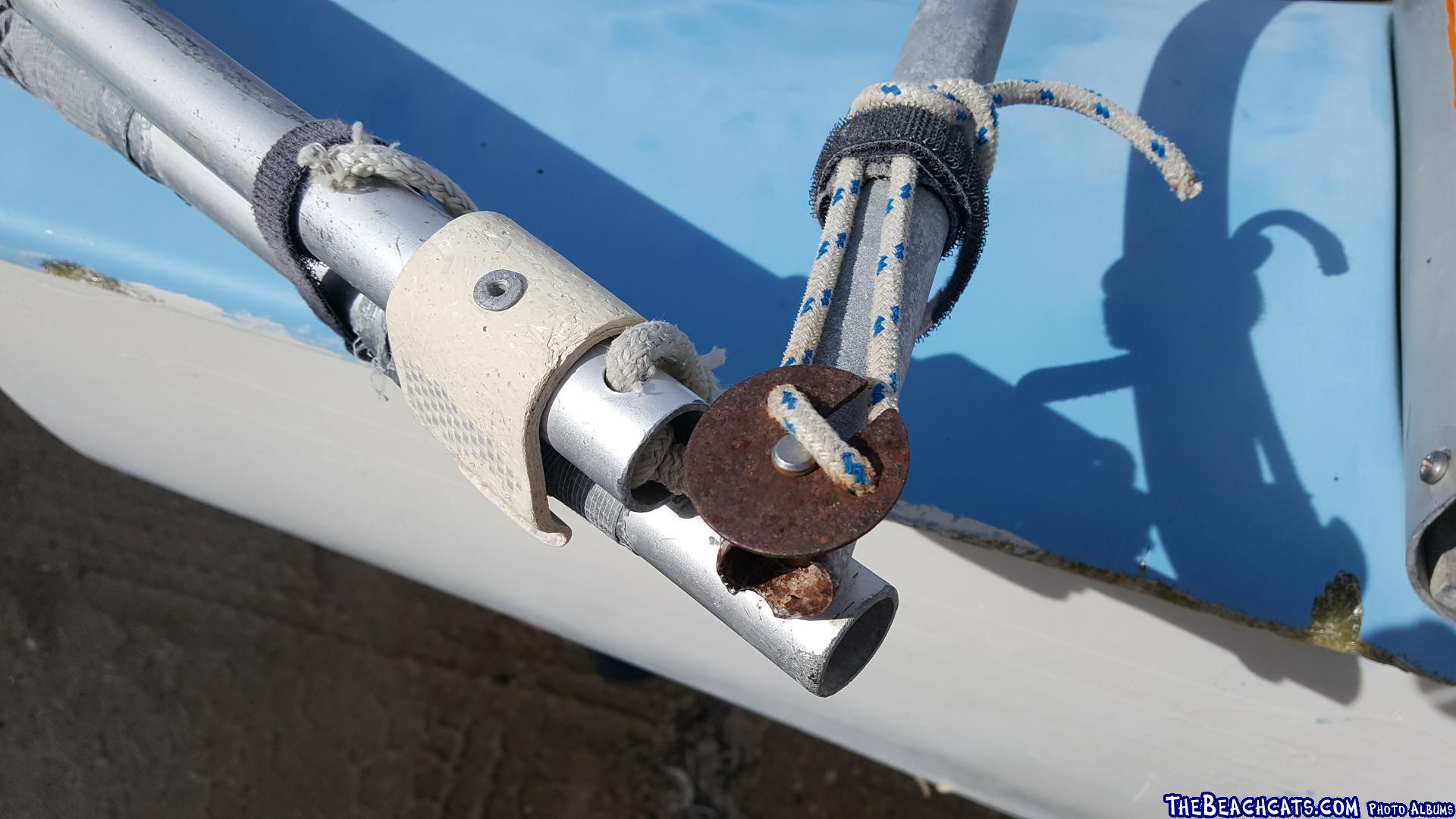

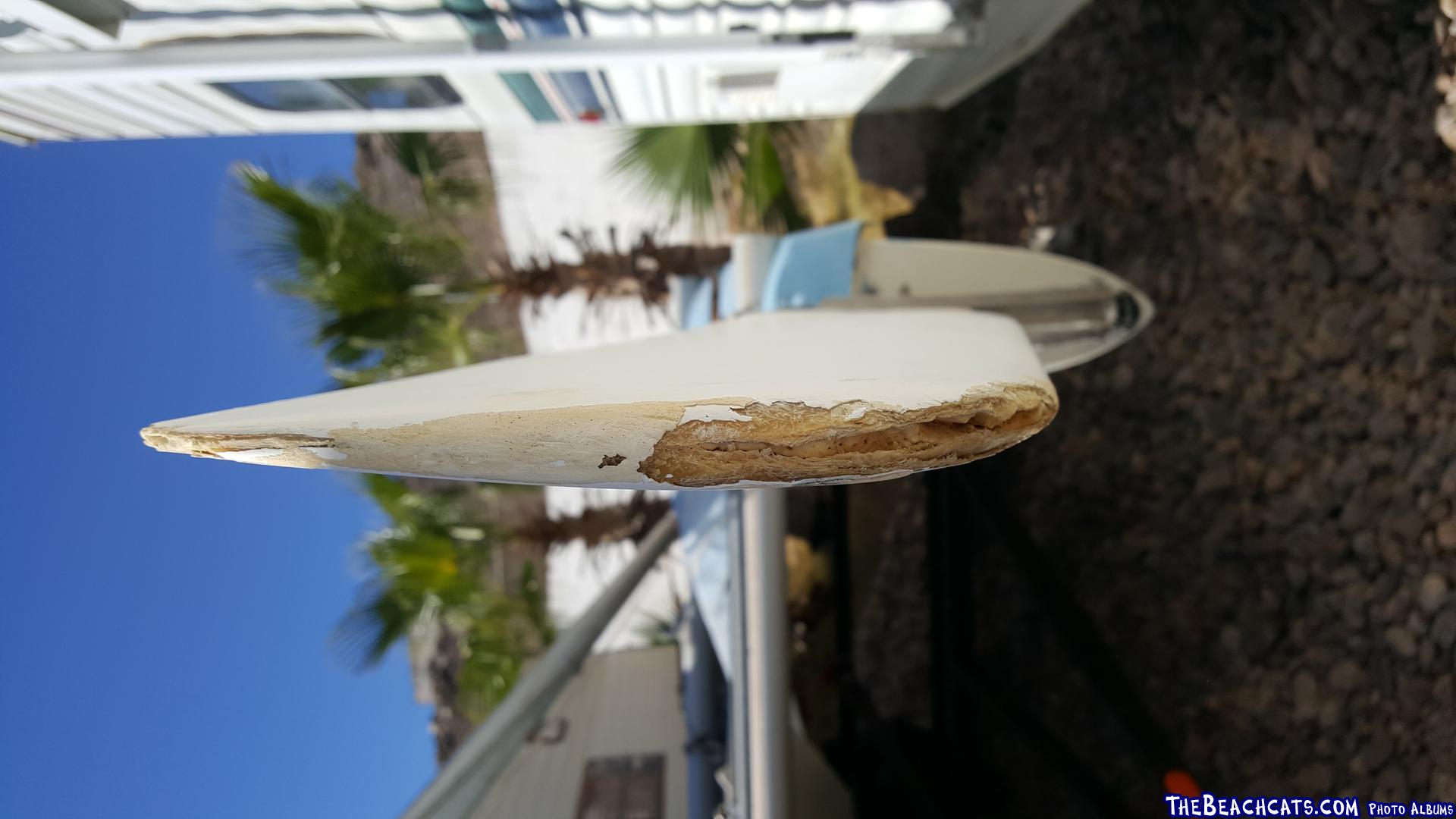

  • Pivot Arm and rudder blade
    https://www.thebeachcats.com/pictures?g2_itemId=128671
    https://www.thebeachcats.com/pictures?g2_itemId=128659
    https://www.thebeachcats.com/pictures?g2_itemId=128662
    https://www.thebeachcats.com/pictures?g2_itemId=128665
    https://www.thebeachcats.com/pictures?g2_itemId=128668

  • Don't worry too much... Lot's of these fine boats are still around. If you do find separation at the hull-to-deck joint, my advice would be to Dremel into the crack/separation as deep as you can, then fill it in with West System 610. Most of the time the cracking is just next to the beams. Worst case scenario, you could one day Dremel out the joint along the entire length of the boat, and stuff the gap with WS 610. I would not pop off the deck with the idea to re-epoxy the entire thing. I did that, and the only thing that saved me from a hopeless project was some kids that came by and vandalized the boat. Then my insurance kicked in....

    I did attempt to post links to several pictures but I'm also having issues with opening the urls. Pics are in the "Beachcats Technical" album "Gcat 5.0 Refurb". As you will see, the tiller arms and crossbar where the tiller attaches look pretty bad. Rather than messing with having new tubes fabricated, I was wondering if the whole system could be replaced with a used system from a hobie being parted out.
  • Yes, this boat is in "well tested" condition
    but may have some fun left in it - depends on the quality of the repairs and ability to replace some items (most of the tubing can simply be replaced, the tiller lock down clasp may be harder item to find)
