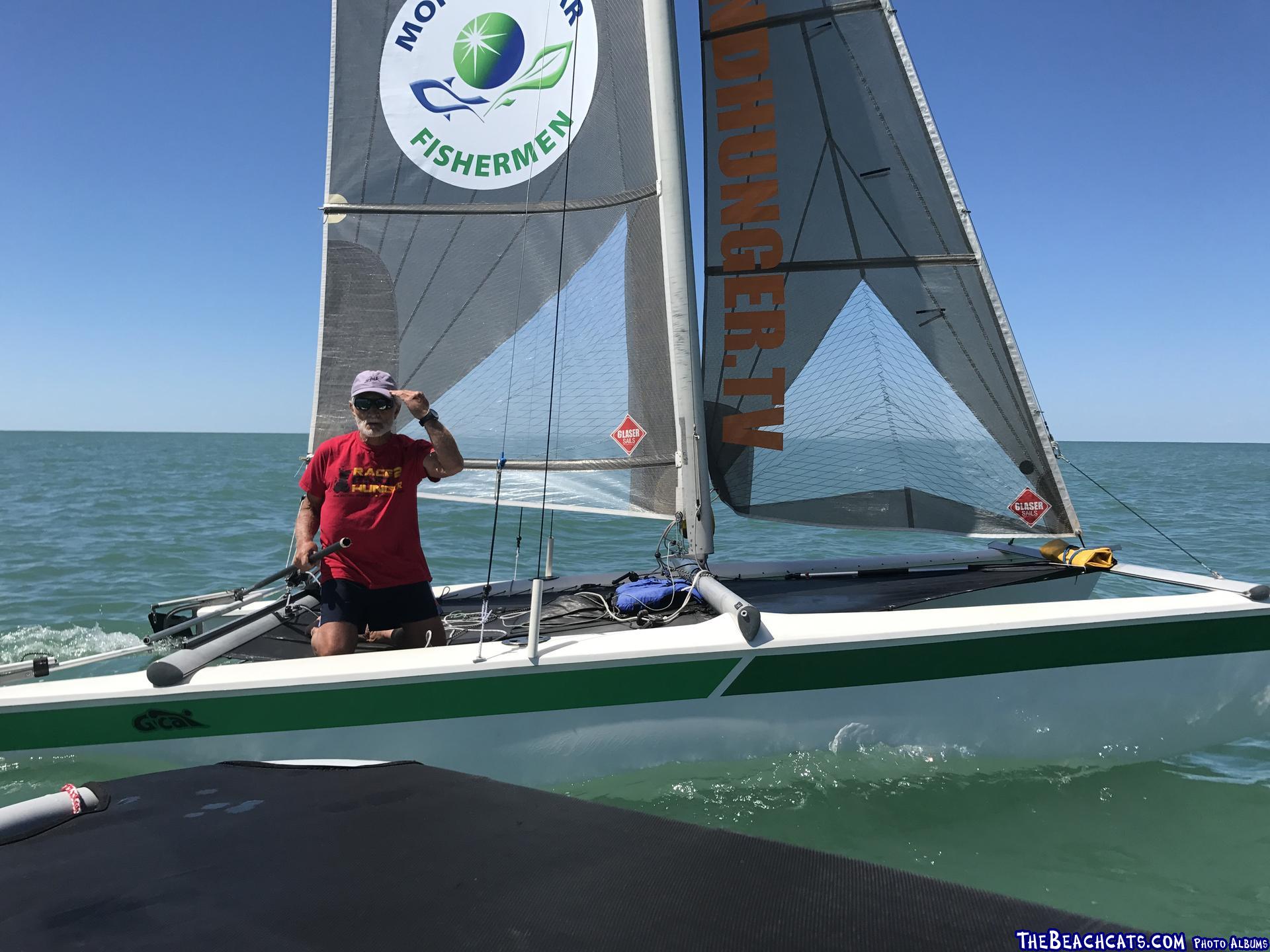

  • g-cats do very well without a boom
    if your not racing, you probably can do without
    you will need a good / heavy batten on the bottom pocket, and a multi hole clew plate so you can hang your blocks in different locations - (to take the place of your outhaul)
    Here is a picture of Hans G (cat) - himself, i took last month - on his 5.0 sans boom
    https://www.thebeachcats.com/gallery2/main.php?g2_view=core.DownloadItem&g2_itemId=128305&g2_serialNumber=3
    Edited by MN3 on Jul 07, 2017 - 01:45 PM.

    You can definitely go boomless with sail modification (I think the foot would have to be shortened and a clew plate added to fit existing cross beam/traveler location), as you can see with the picture above. You would lose some sail area. If I were you, and given what you have said, I'd go boomless, particularly if the price to modify isn't that high. One of my biggest complaints about the GCat 5 is how low the boom is. It makes coming about and jibing difficult with more than one person on the boat. People are always getting scrapes from the boom, even when going aft during the turn.

  • MN3g-cats do very well without a boom
    https://www.thebeachcats.com/gallery2/main.php?g2_view=core.DownloadItem&g2_itemId=128305&g2_serialNumber=3Edited by MN3 on Jul 07, 2017 - 01:45 PM.
    Nice pic (and very nice/expensive sail!). I heard from a G-Cat owner in Dunedin that he got badly injured a couple of months back and is now selling the G-Cat in the picture. Is that not true?
