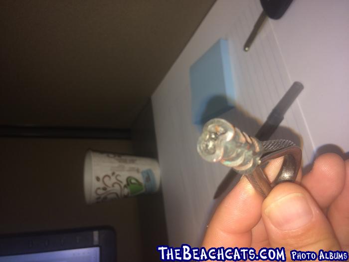

    I have had 1 bow tang failure, 1 side tang failure, and 1 side-stay failure in the past 8 years on my 5.5 - none of them showed any signs of cracking or broken strands. all failures were internal where you can't see or inspect.
    2 year old stay that looked perfect - had internal spot of rust - not uncommon - caused a demasting about 200' offshore at the end of a great day - i was surrounded by kayaks, swimmers and SUP's and was very happy i didn't hit anyone with a mast
    https://www.thebeachcats.com/gallery2/main.php?g2_view=core.DownloadItem&g2_itemId=128039&g2_serialNumber=4
    Bow Tang that looked ok but had a little bit of discoloration

    Thanks you. This is a new failure to me, I've never seen or heard of such a thing. I wonder if it has to do with the small diameter of the lines. I'll certainly be replacing in the near future considering the risk. Looks like new shrouds and mainstay are just $100 off ebay.
    I am however curious on the tang failure. That seems like it would have been the result of long years hard sailing... is there any way to account for that?

    QuoteI am however curious on the tang failure. That seems like it would have been the result of long years hard sailing... is there any way to account for that?
    Yup, years of hard sailing in salt water
    I sail around 120 days a year, and have owned this boat for 9 years or so now.
    hard sailing and constant tacking creates metal fatigue cycling (so does the heat and sun here in fl)
    sailing in salt water creates perfect conditions for rust and galvanic corrosion -
    Beach catamarans are built to be as light as possible, and i would bet that boat dealers really wouldn't mind if your boat fell apart after a few years - and had to buy another. That means spars and fasteners are expected to last a few years of hard use - anything more than that and ... you are "out of your warranties life span".
