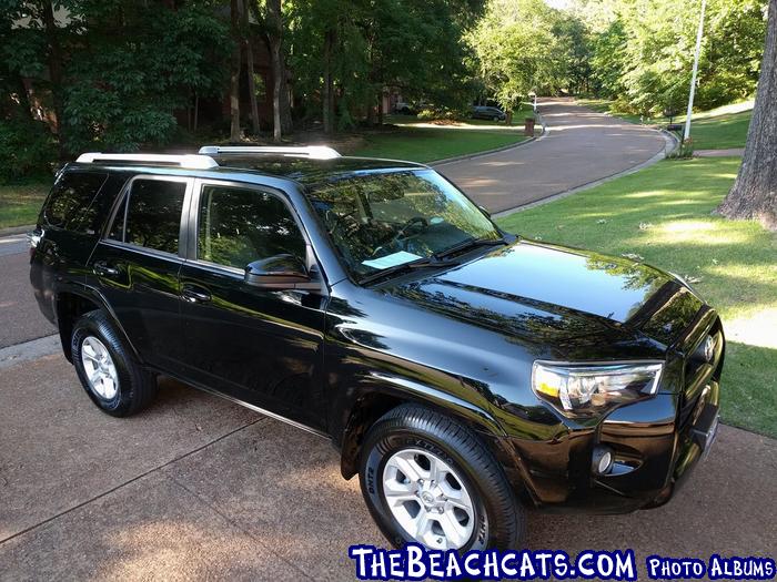

    Anyway, my solution was a 2014 Toyota 4Runner
    https://www.thebeachcats.com/gallery2/main.php?g2_view=core.DownloadItem&g2_itemId=127742&g2_serialNumber=4
