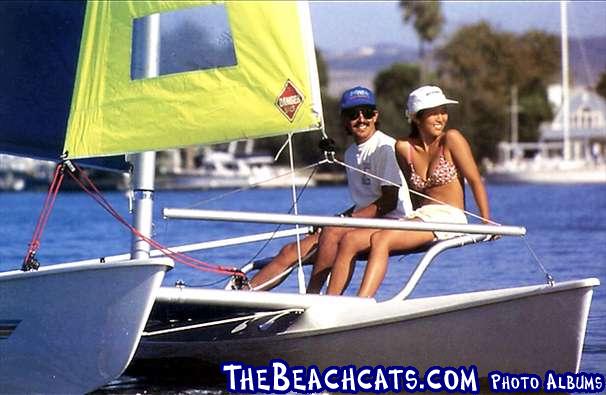

  • Yes this can be done and was done from the factory at one time for the Prindle Escape... this was a Prindle 18 classic with the 16 mast and sail plan... the jib blocs were mounted to the front beam. Here is a picture...
    https://www.thebeachcats.com/gallery2/main.php?g2_view=core.DownloadItem&g2_itemId=81481&g2_serialNumber=3
    What Pete recommends is a great idea... but you can go real simple with a pad eye, shackle, spring, and a Prindle 16 jib. If you have a barber hauler set up, your 3/4 the way there..

  • QuoteYes this can be done and was done from the factory at one time for the Prindle Escape... this was a Prindle 18 classic with the 16 mast and sail plan... the jib blocs were mounted to the front beam. Here is a picture...
    yup can be done!
    (notice the added foil? that is so your bows don't implode inward in a gust/heavy sheeting)
    & that's with a shorty mast, and smaller jib
    moving your bridal forward will change the tension/torsion on you hulls, require a new bridal, new forestay, new jib (maybe) , move your center of effort and in the end ... could fail and destroy your boat - ymmv
    (not to mention the inferior performance of your cat and new jib setup)
    not sure how these tangs attach - maybe a bar under the deck lip?
    my cat has internal braces to avoid the bow tangs from being ripped out of the decklid/gunnal area
    https://www.thebeachcats.com/gallery2/main.php?g2_view=core.DownloadItem&g2_itemId=123657&g2_serialNumber=3&g2_GALLERYSID=8f22c24f235a0b8c5fb0add82bc6fb01
    this may work - but there is NO WAY i would make modification like this on a cat. I am willing to add weight to get more "utility" (add a front tramp, carry an anchor, spare parts, medical kit, radio)
    but our cats are old - epoxy is old and brittle -foam is old and degraded or wet.... I wouldn't make a structural change without some type of additional structure to handle the changed loads
    IMHO - I would sell the boat and get one better suited for my needs before i would make a modification like this

    yup can be done!
    You have a point there, but if that was the case it may have been cheaper for them to put in an additional bulkhead and/or a stringer at the bows during construction to keep the bow from towing similar to how they do with the modern F18's, Inter/NACRA 20.. for handling the load for spinnakers... probably would have cost them what $2.00 for materials and 15 minutes work?
    From what I understand the bridal foil for the Prindle Escape was there for a lower footing jib so they were able to get the same sail area of the Prindle 16 with out the sail overlap.
    Keep in mind the Prindle Escape was not designed for racing etc... At the point of this production run the Prindle 18-2 and 19 were old news, no new 18 classics had been sold in a couple of years, the NACRA 6.0 and 5.8s' were winding down with the NACRA Inter 20 and 18 had just hitting the market... It was a boat that was designed for the hotel/resort rental market to go after the business Hobie was getting with their Waves... It was very simple to use and gave the user enough sail area to have some fun, and not get themselves in trouble with an uncluttered deck making it conformable for the skipper and crew. The factory brought a couple out to to the Long Beach Clairmont ramp on a pretty gusty day.. they were a blast to sail.. but even single handed I had a hard time getting it to fly a hull, plow, and pitch pole.

  • QuoteYou have a point there, but if that was the case it may have been cheaper for them to put in an additional bulkhead and/or a stringer at the bows during construction to keep the bow from towing similar to how they do with the modern F18's, Inter/NACRA 20.. for handling the load for spinnakers... probably would have cost them what $2.00 for materials and 15 minutes work?
    hard to know what was cheaper 20 years ago as a company was in it's end of life stage: changing production lines and methods + adding materials vs. adding a small metal bar above the hulls
    either way .... the "need" was probably based on several reasons.... costs (and profit), ease of install and use, decrease the likelihood of failure, and better jib positioning to help with the reduced main sail area
    the 1989 ad states - "an innovative bridle mount system results in a larger jib that propeles the Escape at exciting speeds and allows for easier tacking"
    http://www.thebeachcats.com/gallery2/main.php?g2_view=core.DownloadItem&g2_itemId=81480&g2_serialNumber=3
