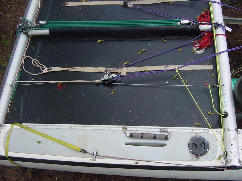

  • THis would be your "typical way"
    https://www.catsailor.com/bb_files/149744-Jibtravelerandsheet8.jpg
    another pic
    https://www.catsailor.com/bb_files/19888-deck_layout.jpg
    The only real variation i have seen would be to run the line through the front beam
    I was considering placing my hauler lead on my wings.. i tried a few times but the extra line on deck wasn't desirable, and it added another "tanglement hazard" during rigging/de-rigging for me so i just put it back to where it normally attaches (front beam)

  • thanks for the examples, I wonder how much more effective the 1st picture is vs. the second, pulling from in front of the beam instead of behind.
    1988 Nacra 5.2
    YouTube link to see boat in action:
    https://www.youtube.com/playlist?list=PLddinE6IorSrPpZrlvcwAjRzSIQsKYPG1
  • I think you will find a negligible difference -
    I think it is much more important where you place/face your cleat. If you don't direct it in the right direction, it will be a pita to cleat or uncleat
    my guess is the skipper placed them forward because that cleat was already there in the typical place (on the aft side of the forward beam) - i would also say the line could get fouled on the beam bolt or clam cleat in that example - requiring crew or skipper to go down to the low side to mess with it
    The goal is to get the jib clew out and forward.
    you can test different mounting locations prior to drilling:
    test on the beach: place the bows into the wind and play around with your jib - see where it "sits" with different block locations
    if your in VERY light air, you can test with the sterns into the wind
    on the water: just use your (crews) hand to hold the jib clew in slightly different locations - this is how they did it before mr barber invented this system

  • loquinhoIt appears my Nacra 5.2 barberhauler system is done internally in the front beam. There's a small semi-recessed block at each end of the main beam with a small cam cleat adjacent to it.
    http://i791.photobucket.com/albums/yy199/equacken/20161122_074023_zpsvygav56n.jpg
    I have seen similar - it's great to get lines off the deck but i am NOT a fan of that Lance Cam Cleat. Looks like it could be a real PITA to uncleat (est from the other side of the deck)
    Also the bullet block that is being used there may work but on the other example of "in beam rigging" there was a nice "unit" in that location. It was in a self contained unit with a turning block recessed and a small cam cleat also in the unit (it was encased in a small metal box). looked like it would not only run the line correctly but also probably added some strength to the beam where it had been notched out
  • thanks a lot for those pictures, Wow, you have your hands full with that one. But another 5.2 cleaned up will be a win for sure.
    nice seeing a very different design. I may be a bit confused on that piece that the line runs through onto the hull. also seems like you would of wanted it a bit out farther...but some is much better than none. I love the idea of running things through the crossbar, but I felt it would be a bit risky to deal with so I think I have a different plan with a mini cheek block, and a clamcleat on the opposite side. Keep us up on your progress.

  • Quote I may be a bit confused on that piece that the line runs through onto the hull. also seems like you would of wanted it a bit out farther...but some is much better than none.
    I agree - not the most optimal location (and maybe not worth doing like that due to the location) but the beam straps would prohibit much more of an outward location. Atl least it is pulling the jib clew forward to the beam which will be beneficial
    Quote
    I love the idea of running things through the crossbar, (BEAM - crossbar is the part that connects the tillers on a catamaran) but I felt it would be a bit risky to deal with so I think I have a different plan with a mini cheek block, and a clamcleat on the opposite side. Keep us up on your progress.
    What is "risky"? (besides cutting holes in your beam?)
    cheek blocks and clam cleats are not optimal here. - cheekblocks sit flush so that would not produce a favorable sheeting angle and will cause your line to frey (i recommend a small block that is on an eyestrap so it can articulate - clam cleats are also not the best option (IMHO) as they would require more precise line management to cleat and uncleat, i would recommend a regular set of cam-cleats but a cam cleat could work, just not optimal
