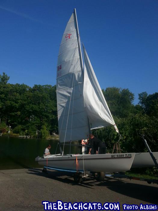

  • http://www.thebeachcats.com/gallery2/main.php?g2_view=core.DownloadItem&g2_itemId=125961&g2_serialNumber=4
    I bought a 19 last month..took it to a small lake for its maiden , wind was around 12 - 15..
    My buddy & I were only going but then.. my neighbor pops over wanting to go & so does my 14 yr old daughter,
    588 lbs on board, best speed was 14.2 according to RACE QS..ABSOLUTE BLAST icon_cool
