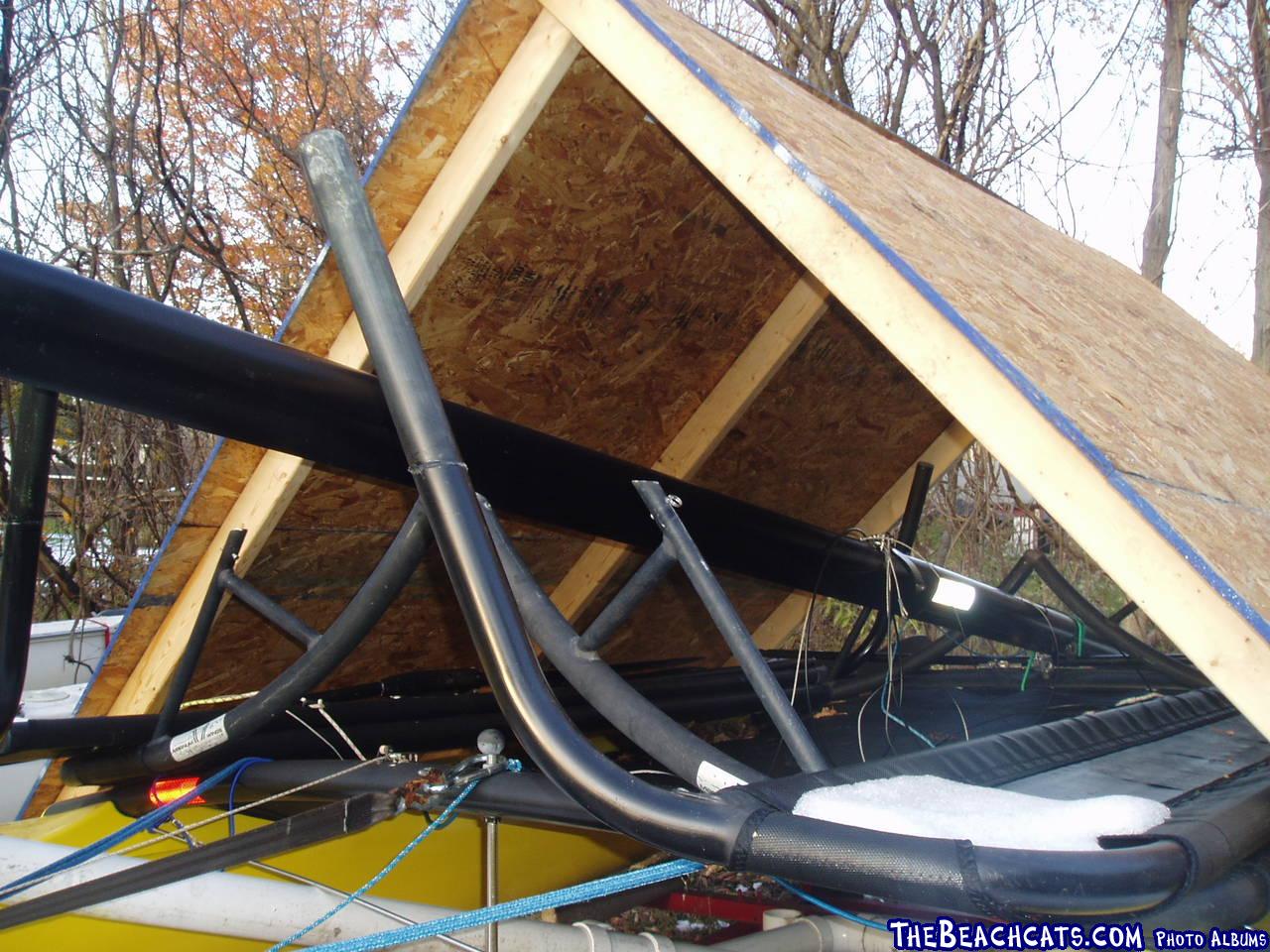

Building a temporary A-Frame to prevent snow build-up

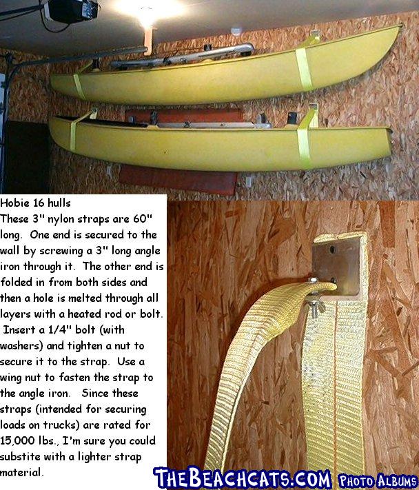

Wall mounting

~~~ Yeah, thats my rollers havin sex with my hull. I'am not sure what year it was but when it started snowing it didn't slow down for about a week or more and it came down heavy. By then it was kinda late so I let it go. Guess I paid for it. What I do now is take the boat off the trl and cover it like Edchris does... A friend of mine has a Hobie 18 SX and left his on the trl. The weight of the snow broke both of his springs on his trl. He paid alot to get new ones. So if ya live in snow country... unload yer boat ~~~~~
