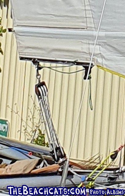

  • Speaking of expensive sails, they offer a laminate tri-radial sail with the clew plate I'm familiar that attaches to my 7:1 with S-hook, and this boomlet. How does this work?
    https://cdn10.bigcommerce.com/s-6y6ht/products/409/images/4460/DSCN9023__80677.1511312277.1280.1280.JPG?c=2
  • i have seen those with a small harken track and car that act as the outhaul. there will be a turning block and clam cleat in there too that allows the skip/crew adjust and lock the outhaul into place
  • Well, if I ever get the coin to build a sail, it will probably be the clew plate. What I'd really like to do is get a furler for the jib and get that built with the vertical battens.
  • tominpaSpeaking of expensive sails, they offer a laminate tri-radial sail with the clew plate I'm familiar that attaches to my 7:1 with S-hook, and this boomlet. How does this work?
    Looks the same as my current (old) sail on the 5.8, https://www.thebeachcats.com/gallery2/main.php?g2_view=core.DownloadItem&g2_itemId=135999&g2_serialNumber=3
    Apparently it's been proven that it doesnt offer any advantage over the clew plate.

  • The boomlet offers “infinite” adjustability over the same length as a clew plate with less build cost to the sail (assuming you already own the boomlet.
     https://cdn10.bigcommerce.com/s-6y6ht/products/1235/images/4835/DSCN3791__97841.1562184894.1280.1280.jpg
    http:// https://www.slosa…boomlet-for-nacra-sails/
    Edited by carbonc on Nov 22, 2021 - 11:37 PM.
  • Thanks for information on the boomlet. I had never seen one rigged and didn't know how they worked. Good to hear the clew plate works as well, but the boomlet seems to be more adjustable while underway with tension on the sail.
  • tominpaThanks for information on the boomlet. Good to hear the clew plate works as well, but the boomlet seems to be more adjustable while underway with tension on the sail.
    I had clew plates on my 5.8 sails and used the adjustable track on a buddy's 5.8. The track is nice for easy adjustment. Most people will not notice the difference between moving the sheeting point aft. I had a system for making adjustments while under way with the clew board. I had a hook on the mainsheet and a short "tag line" that was attached to the aft hole. When rounding the top mark, I would reach back, unhook the mainsheet from the forward holes and it would automatically sheet from the aft hole. At the leeward mark, I would grab the hook and reposition it in the upwind hole. It took some juggling and was difficult with a dozen boats rounding at once.
    QuoteI had never seen one rigged and didn't know how they worked.
    The traveler line on the car running forward pulled the mainsheet forward to flatten the sail. Release it and the sail forces pull the sail forward relative to the mainsheet.
