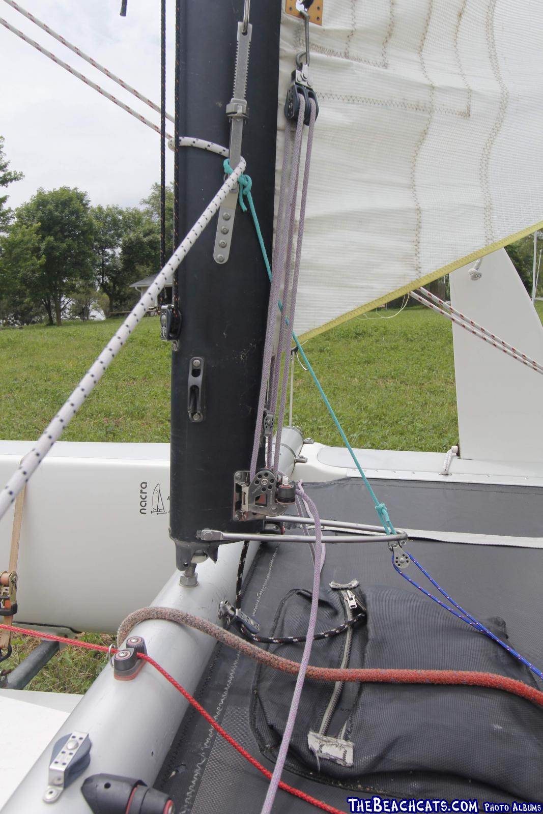

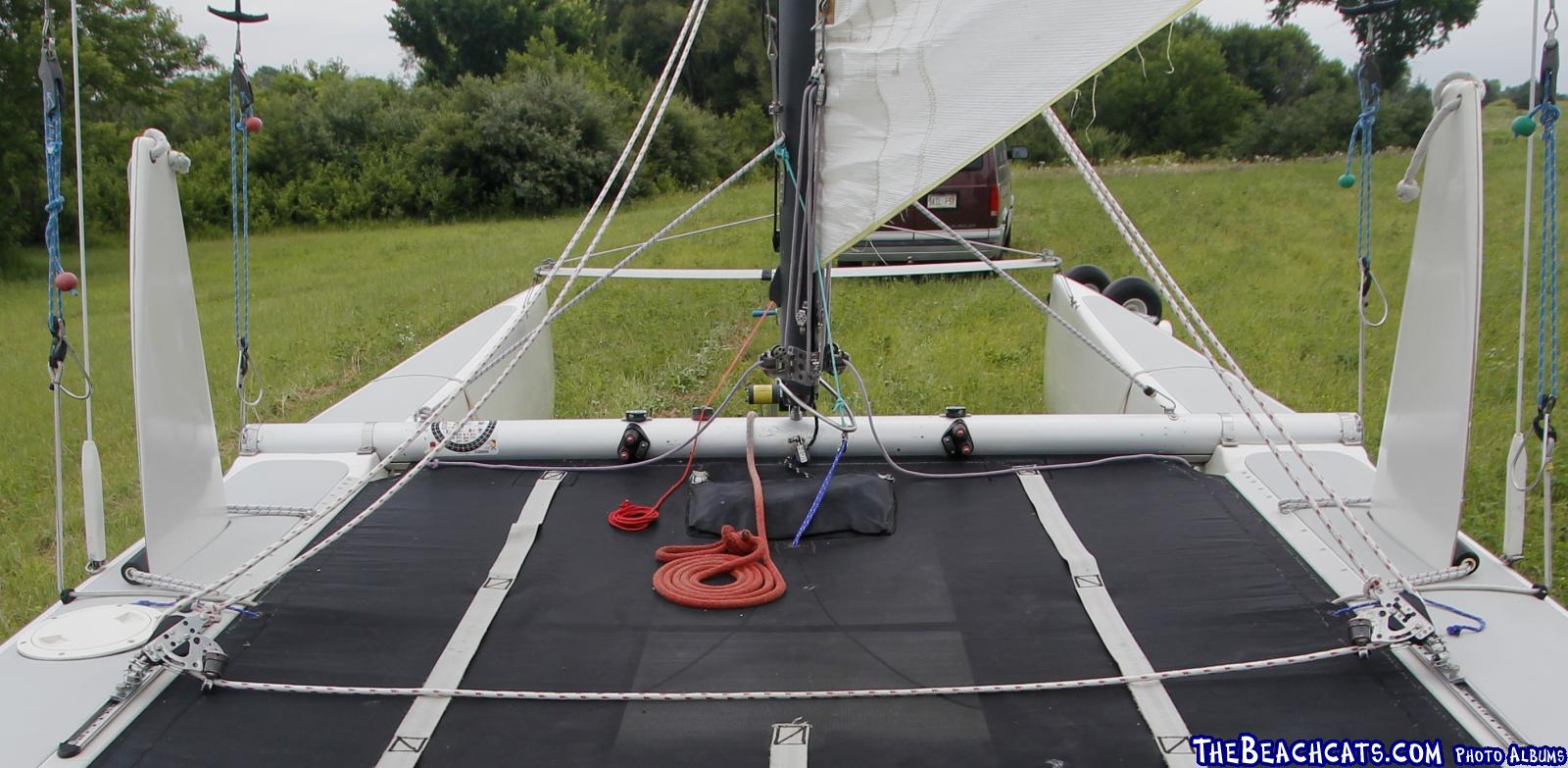

  • here's what my 5.8 setup looked like. teal colored line was used as a rotator topping lift. this arrangement won't help you induce rotation, just reduce rotation.
    j
    http://www.thebeachcats.com/gallery2/main.php?g2_view=core.DownloadItem&g2_itemId=124249&g2_serialNumber=3
    http://www.thebeachcats.com/gallery2/main.php?g2_view=core.DownloadItem&g2_itemId=124245&g2_serialNumber=3
    http://www.thebeachcats.com/gallery2/main.php?g2_view=core.DownloadItem&g2_itemId=124253&g2_serialNumber=3

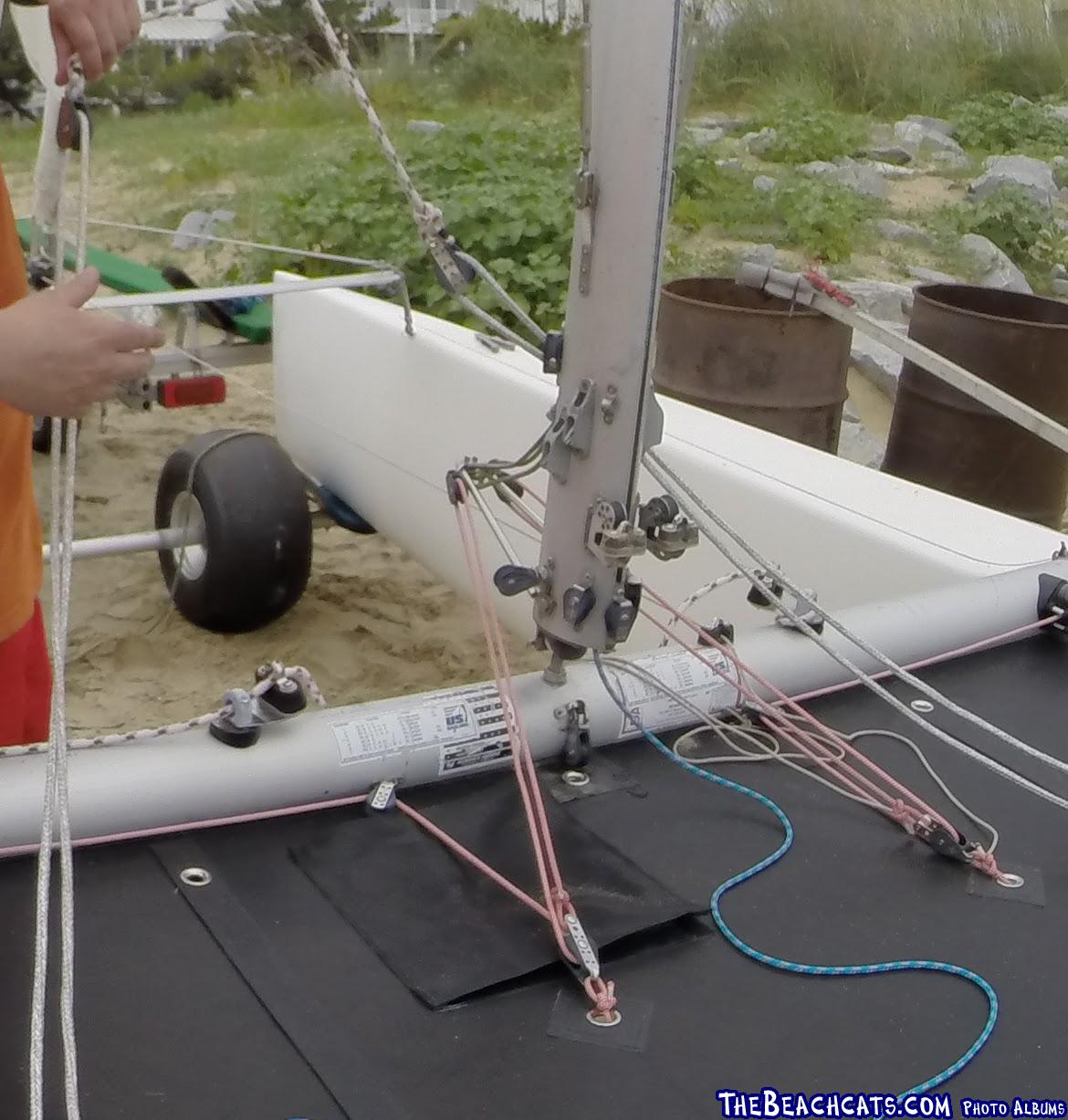

  • I don't have firsthand experience with the 5.8. I thought all the boomless models faced the wishbone forward?
  • Here's a picture with the arm pointing forward. This arrangement enables over-rotation of the mast (>90 degrees) when on a broad reach. Also shown is rigging for a 2:1 control line. The block at the trampoline is secured by a short pigtail with a stopper knot below.
    http://www.thebeachcats.com/pictures?g2_itemId=123614

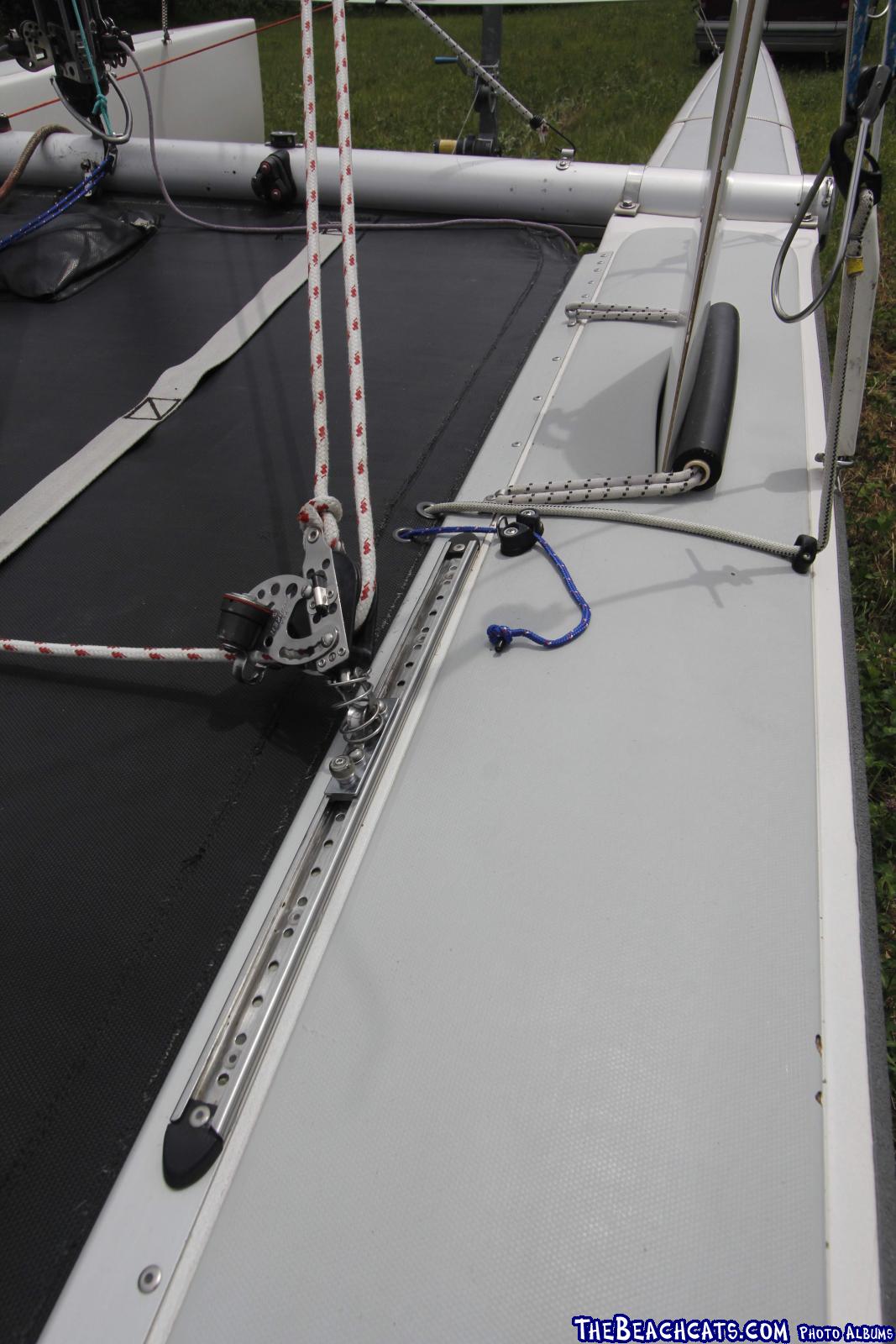

  • Here's the image. (I posted originally using my tablet and did not find a "copy image address" option.)
    One thing I forgot to mention is that the working end of the control line is secured in a clam cleat attached to the front beam. You can see a portion of the starboard cleat at the right edge of the photo.
    http://www.thebeachcats.com/gallery2/main.php?g2_view=core.DownloadItem&g2_itemId=123618&g2_serialNumber=3
