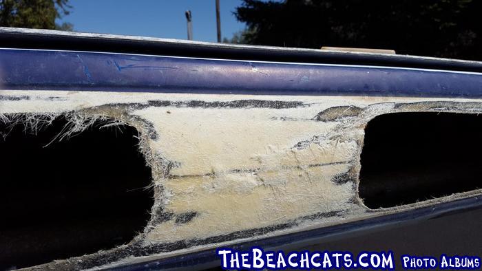

  • I removed the deck plate that was delaminating today and added several images to my rebuild album on This End Up. Seeing this up close,
    http://www.thebeachcats.com/gallery2/main.php?g2_view=core.DownloadItem&g2_itemId=124164&g2_serialNumber=4
    I do think the thickened epoxy will be the way to go. It will give excellent strength and should seal up well too. But you will never take the deck plate off again in the same manner as this one came off. The strength of the epoxy bond simply will not separate like this did.
    I see some white hard material in the old bond area, but I wonder if that is just gelcoat? It looks more like they shot some chopped glass on the deck and then bonded it.

  • I think that is probably the layer of mat between the deck and the hull
