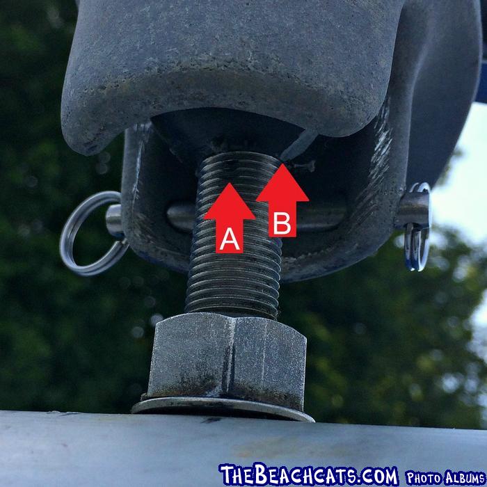

  • No matter how tight I tighten my mast ball it has always been backed off (loosened) a turn or so when I check it after a de-rig. I thought some type of thread locker/sealant might do the trick. I decided to go with an old standby sealant/adhesive I have used on many things successfully for years, "Goop."
    http://www.homedepot.com/p/Amazing-Goop-3-7-fl-oz-All-Purpose-Adhesive-140211/202533796
    After removing and cleaning the threads on the ball and rod I applied a bead to both and reassembled tightening the ball very tight. I then put aligning marks on the ball with a silver Sharpie and the rod with a black Sharpie. Several days later I went out for about 3 hours and upon making shore inspection showed that the ball had backed off about a quarter of a turn.
    http://www.thebeachcats.com/gallery2/main.php?g2_view=core.DownloadItem&g2_itemId=123940&g2_serialNumber=4
    Any suggestions to keep the ball from loosening?

  • I have 2 Nacras with the same mast base/ball that you use.
    Your problem is very easy to solve.
    Screw the ball hand tight, spray with jigaloo, or similar... go sailing, & forget about it. yes forget about it.
    The mast base is not polished, & it will "grip" the ball.
    As the mast rotates, it will rotate the ball, BUT, it does not rotate the ball, let it stay there while it pivots on top, & then rotate it again, unscrewing it.
    The ball simply turns a bit as the mast rotates, then turns the other way as the mast turns back. At the end of the year, the ball will be within a 1/4-1/2 turn of max tight, & everything is fine.
    It won't unscrew itself, so go sailing & ignore it.
    the ball is delrin, almost nothing sticks to it, you cannot "glue", or loctite it to the SS rod. This one has been "turning" for 5 years.

  • Edchris177It won't unscrew itself, so go sailing & ignore it.
    Thanks Ed. That is my conclusion as well.
    Murray's says the ball is nylon, but nylon or delrin more or less the same issue with bonding to anything.

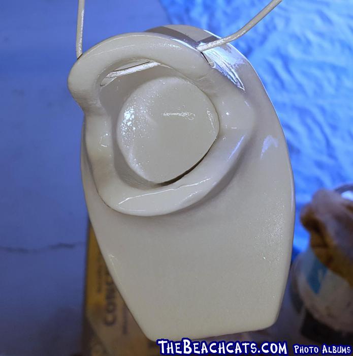

  • Quotei have always been amazed that nacra didn't 'polish' the mast base inside where it sits on the ball.
    Here is what my mast base looks like now after 1) 2 wash coats. 2) three coats of Awlgrip 545 primer and 3) 3 coats of Awlgrip 2000 two part urethane.
    http://www.thebeachcats.com/gallery2/main.php?g2_view=core.DownloadItem&g2_itemId=124098&g2_serialNumber=4
    It isn't polished, and who knows how long it will last, but it does look pretty good now.
    Edited by dmgbear55 on Aug 01, 2016 - 10:35 PM.
