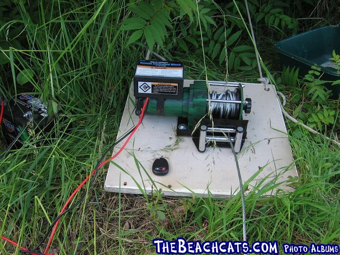

    I also have a marine battery and remote controlled ATV winch that i mounted on some bed frame rails i had lying around. i put a winch "hook" on the back of the unit so i can attach it to just about any fixed object (car, tree, post, etc) but have never used it (i have somewhat mastered how to roll my 5.5 up the beach solo by pulling it sterns first and angling it up the slope - or i ask for help)
    I know Dave Farmer on this site uses a similar system (but he actually uses it, mine collects dust)
    http://www.thebeachcats.com/gallery2/main.php?g2_view=core.DownloadItem&g2_itemId=113088&g2_serialNumber=4
    http://www.thebeachcats.c…ictures?g2_itemId=113087
