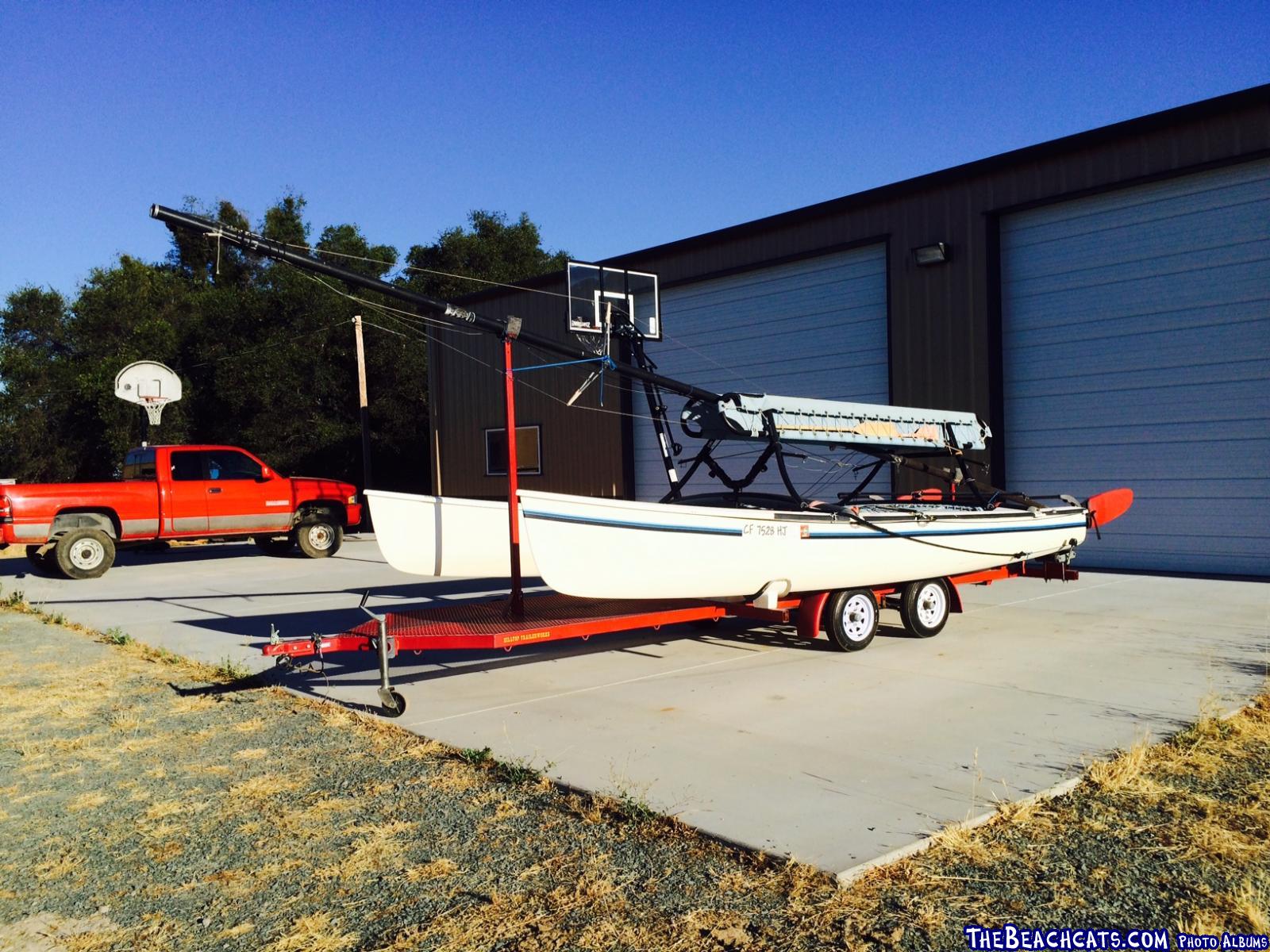

  • I picked up the new wave on Monday! :) I ended up getting the club version (3 piece tramp) but I can confirm that the hulls on the club and classic are the same so you can essentially switch between each version by simply buying a new tramp and some misc hardware. It isn't like the old days where the classic didn't have tramp tracks, now they both have tracks and the classic has some metal hooks that slide into the track and the tramp hooks to those.
    Here is a pic of my double stack trailer I built a couple years back without the double stack rack:
    http://www.thebeachcats.com/gallery2/main.php?g2_view=core.DownloadItem&g2_itemId=123602&g2_serialNumber=3
    So my new question is, does anyone have a suggestion for wave cradles? Part of me says it is a tubberware boat, but the bottom has a pretty fine edge with the skeg and 2" steel tubing is pretty hard. icon_smile So does anyone have any suggestions?

  • So I thought I would give an update to this story. So I couldn't find a good way to double stack with the wings so I'm currently removing them, and I need to find a good way to trailer them. But here is a pic of the boats
    http://www.thebeachcats.com/gallery2/main.php?g2_view=core.DownloadItem&g2_itemId=124413&g2_serialNumber=3
    I found that with the skegs I had to load the boat backwards or else I had almost no tongue weight. I'll try to post another pic once I figure out how to trailer the wings efficiently.
