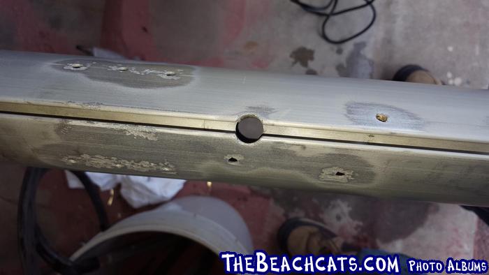

This mast is very light and very bendy. I just uploaded an image of the large hole I have to deal with in my Technical Album. It is not round and I'm not too keen to make it round either, because it is already too big. I think the rubber plug approach could work on the small hole 5/8" hole, but even it would be challenged because it is through the groove for the sail, so nothing flat for a plug to really seal against. But I am going to look at those options.
Another not so pretty idea I had was to take a piece of thin aluminum and make it conform to the shape of the mast and then rivet that in place using silicone as a sealer.
I do think I could make the epoxy patch work well enough too, since the patch would be both inside and outside of the mast like a sandwich. Even if it debonded or cracked it would remain in place and again could be sealed with silicone.

The hole through the back of the mast in the picture above is the small one and could be plugged with a wooden dowel and silicone and be fine for a very long time. The big hole through the front of the mast is really the bigger concern. That is the wet side and I don't want to be slowly taking water on through whatever I use to seal that side. That hole is getting to be large enough to be a structural concern, but there are larger holes at the spreader that have survived over all these years.
