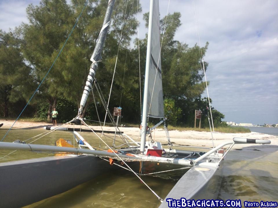

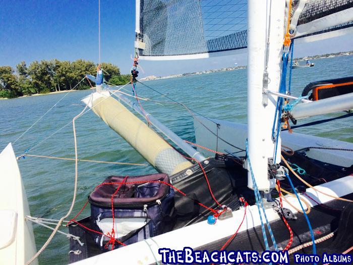

    for my 5.5 - I ordered a rectangle front tramp from Sunrise yacht company - http://multihullnets.com/
    it is perfect - has a pouch on top for my anchor and on the other side (underneath) has a pocket for my righting bag
    it sits right in front of the beam and is tied to the beam and 1 eyestrap on each hull

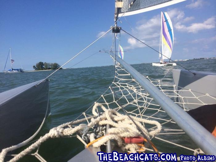

    my 6.0 has a web triangle that goes from beams to furler. it is perfect for my anchor and maybe a dry bag.
    it has no weight nor windage
    6.0
    http://www.thebeachcats.com/gallery2/main.php?g2_view=core.DownloadItem&g2_itemId=120724&g2_serialNumber=3
    http://www.thebeachcats.com/gallery2/main.php?g2_view=core.DownloadItem&g2_itemId=120722&g2_serialNumber=4
    5.5
    http://www.thebeachcats.com/gallery2/main.php?g2_view=core.DownloadItem&g2_itemId=120730&g2_serialNumber=4
    http://www.thebeachcats.com/gallery2/main.php?g2_view=core.DownloadItem&g2_itemId=120735&g2_serialNumber=4
