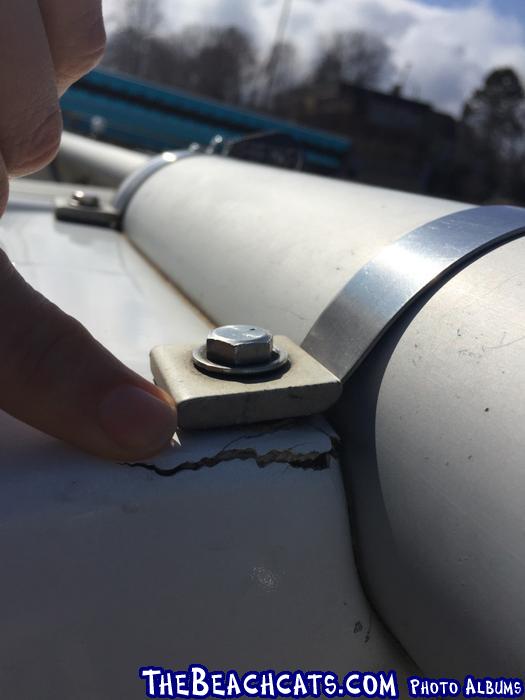

    1. Inboard strap on the forward crossbar has cracked the fiberglass lifting away from the hull slightly

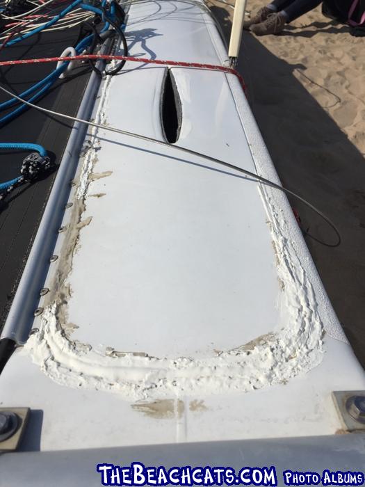

    2. The hulls generally feel firm but one of the hulls has been pretty extensively epoxied on the top in one section

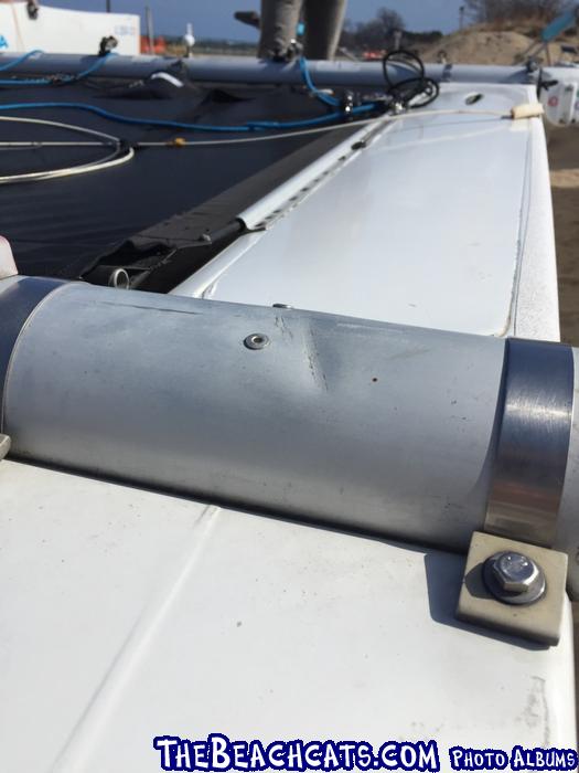

    3. The rear crossbar has a modest dent

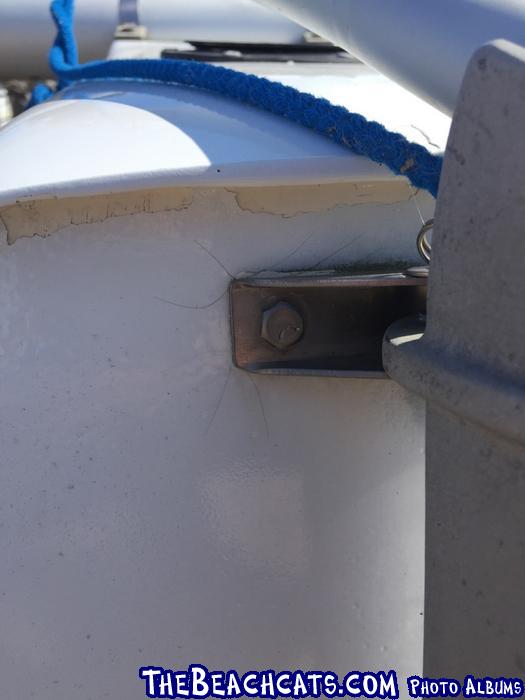

    4. After reading posts in this forum I took a good look at the rear of the hulls where the rudder attaches. I see hairline cracks in the paint on one hull

    Photo 1 - major problem, you need to pull the decking off the hull and find out what is happening inside. Likely the aluminum plate inside has delaminated and overtightening the bolt and stress caused the issue. A number of ways to fix it but you need inside access to do it properly. If the plat is intact you will need to epoxy and fiberglass it into place and also to a repair on the plastic from the outside. Its not as scary as it sounds but its a few days work.
    Photo 2 - could be someone was trying to fix a leak? Again not something you want to leave without investigating, grind off the epoxy and remove the decking (by progresively working a sharp putty knife between the deck and the hull all around). Fix any problems inside and smooth mating surfaces at deck and hull and re-attach with thickened epoxy.
    Photo 3 - A dent like that in a cross bar isn't normally anything to worry about. Lots of cross bars with small dents and drill holes in them.
    Photo 4 - That cold also indicate a major issue with the transoms. Again you would half to probably cut a port behind the crossbar to inspect and fix.

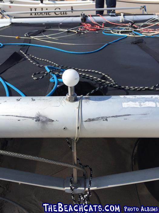

    Photo 5 - not sure what I'm seeing there. Again dents and scrapes in a crossbar are pretty normally, as long as they are straight and round you should be OK.
    Verdict. If you are thinking of buying this pass on it unless it is dirt cheap and you want a project boat. If you have it you will probably be spending the better part of a week on pulling off decks and fixing issues. Probably about 300-500 worth of epoxy, fiberglass, tools and gelcoat. Makes me also nervous about the other parts.
