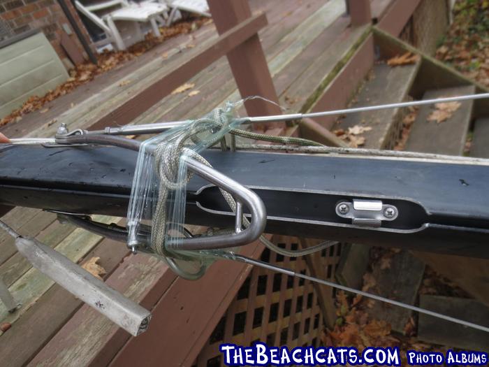

Pete, do you mean run the halyard down to the sheave at mast base, then up to a hanging block?
Or have the halyard exit the luff track at the hanging block?
The 20' Mystere has a small sheave at mast base. The feed groove was slightly offset from center, so you had to place the sail just to the right of the mast.
The H18 looks to be centered, but I'll have to replace that bottom sheave, it is missing from the pin on the mast base.
I will be raising the sail solo 95% of the time, so it will be hoist/feed while standing on the tramp.
Will the extra turning block make it easier?
Should I get rid of that small SS sail guide that is screwed onto the sail feed opening?

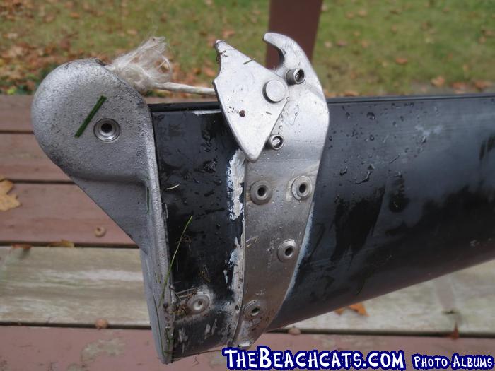

Regarding raising the sail, do most people retain that little SS sail feeder thing that sits in the luff groove?
It is quite small, & looks like you would have to feed the sail exactly, or tear the material.
Is it of any real value vs just feeding into the main groove?
Also, that little swing plate on the sail hook, at mast top...how does that work,(or doesn't)?
The Mystere uses a similar hook,(without the plate), but if I use a thin halyard & rotate the mast, it's easy to hook/unhook.
Lastly, where does the halyard run?
Looking at the masthead sheave, it appears the halyard returns INSIDE the mast. If so, how is it sealed? That will be underwater when flipped...or does it sort of turn 90* and come back down via the luff groove?
Edited by Edchris177 on Nov 18, 2015 - 11:12 AM.
- Registered: Mar 19, 2004
- Last visit: Sep 03, 2025
- Posts: 968
Ditch the sail feeder - it's more trouble than it's worth. Take out the screws, remove the feeder and spacers, and then reinstall the screws with a dab of silicone to seal the mast.
Most people find the flapper on the mast hook to be more trouble than it's worth. The concept is that if you raise the sail so the halyard ring goes above the hook but not above the flapper, then the ring will engage the hook. If you raise the ring all the way to the top of the mast, then the flapper will drop down and block the hook and you can lower the sail. In reality, you can achieve the same thing more easily by just rotating the mast to engage or disengage the hook. The comptip masts don't have the flapper.
The halyard returns down the luff track, so the mast is sealed.

I went with a one way halyard, stayed with the cable I bought, works easily with the silicone spray I also used. Got the sail up for the first time last night. Ground off the hook flapper, made setting the ring much easier.
