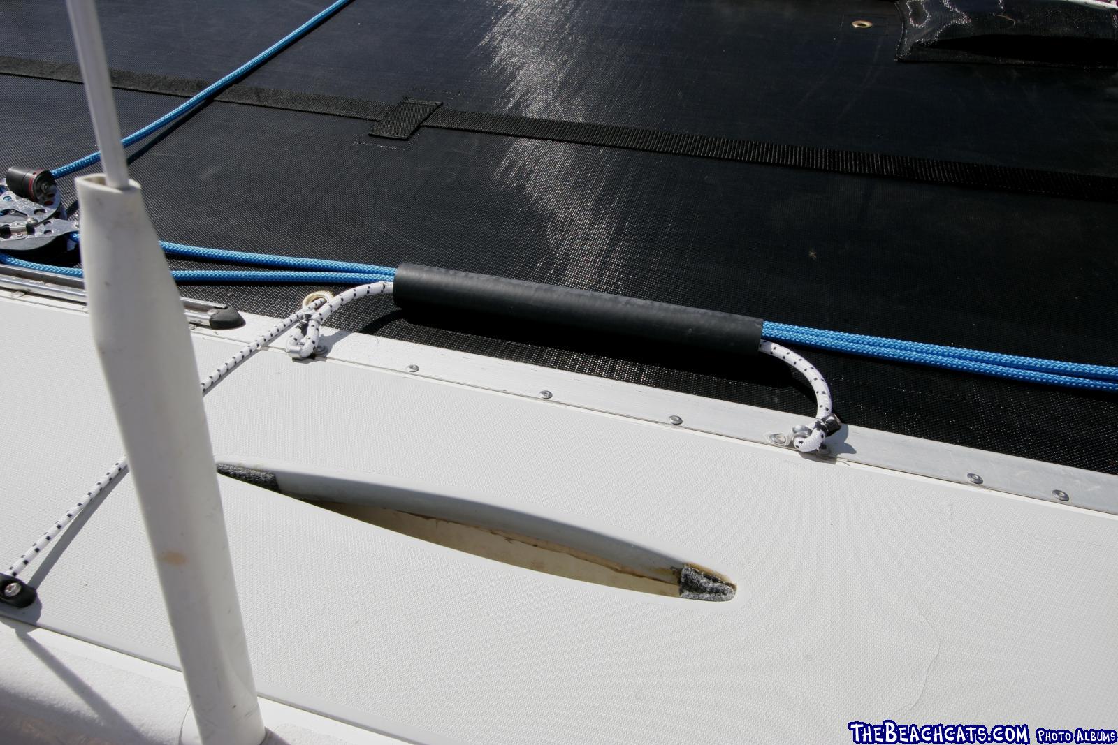

  • klppurdy,
    i put a crack in the back of my daggerboard trunk by gently bumping a submerged tree at low speed. the sharp edge of the daggerboard cracked the trunk just enough to let water in, but it came in fast and filled the hull so fast i barely got back to shore.
    i had this repair done by a boat repair shop. he put in this inspection port, which could have been a 4" instead of an 8", but he was just making it easy on himself! inside the hull, at the back of the trunk, he applied numerous layers of fiberglass to seal the trunk and i haven't had a problem since.
    i've tried applying epoxy from the inside of the trunk and it doesn't penetrate very well and tends to drip if it's at all viscous. but i like that idea of using a vacuum to pull it in, as long as it a gentle suction. might be worth a try.

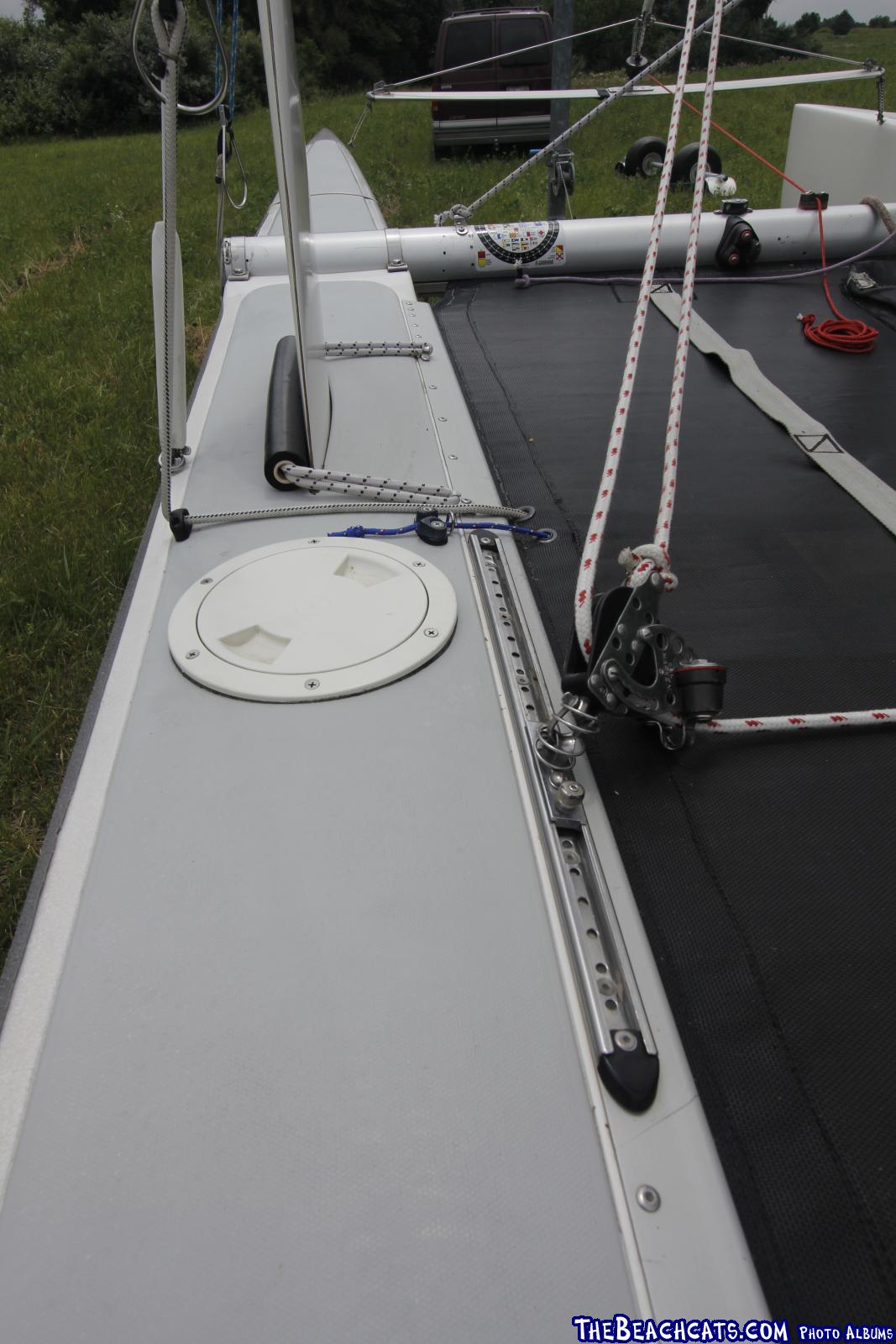

  • I repaired my 5.2 dagger board wells in the spring after hitting a reef with the spinnaker up.
    There are many different ways to do this, some more difficult than others, some cosmetically better etc.
    What I did was first install two 6" ports behind the daggerboard wells (mine already had ports in front! Loads of ports now, but they aren't too uncomfortable. I then cleaned the affected areas and dried then cleaned it up and sanded it with 60 grit. I cut some heavy biaxial tape to manageable lengths. BX tape wraps around corners well. I then made some thickened epoxy paste (thickened with wood fibres I saved from the router).With this paste (peanut butter consistency) I made some fillets (using a rounded spatula, like a tongue depresser) all round the dagger board well to hull join at the bottom. Then I layed up the tape over this and smoothed it out. I added more layers in the weakest spots and left it all to harden out. The repair has held up to some very hard sailing including a full-on capsize, boat fully loaded with two heavy adults, one in the trapeze and spinnaker up.
  • Thanks all for the responses, so it seems like an inspection port and tackling it from the inside is recommended for the best results.
    And Renovator, no I did not think you were hijacking my thread. Its cool.
    When I first looked at this issue, I was thinking of attempting to maneuver a piece of two inch fibreglass tape about 6-7 inches long into the back of the well and securing it with a piece of string to keep it in place. The more I think about this the more I become concerned about dripping resin all over the place and making a mess.
