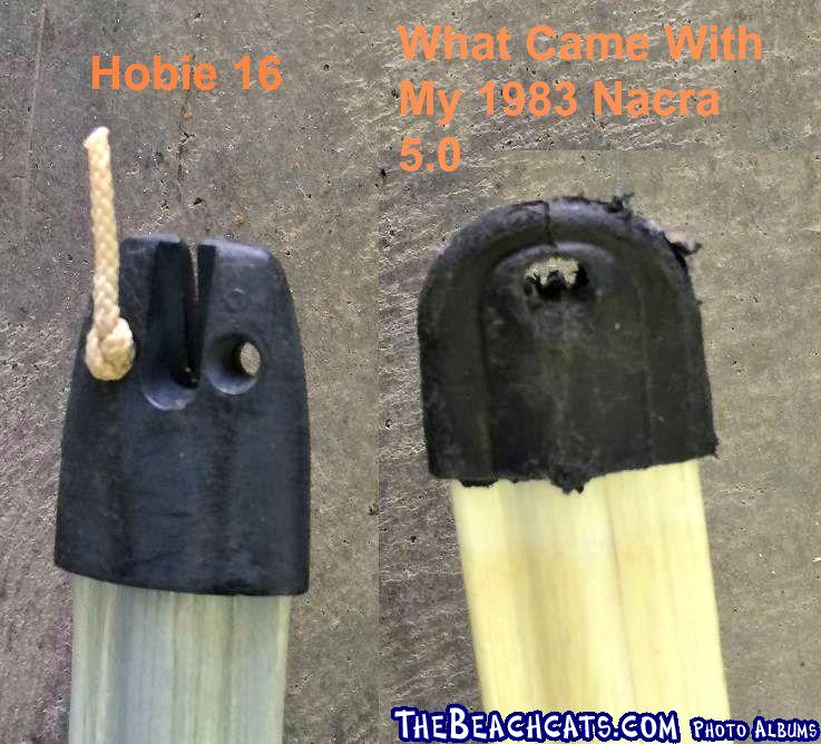

    On the right is what came with my boat:
    leeboweffectLater today I'll take a photo of the caps currently on my Nacra battens and post it here.
    http://www.thebeachcats.com/gallery2/main.php?g2_view=core.DownloadItem&g2_itemId=119707&g2_serialNumber=3
    Having reviewed the Nacra "hole through the batten tie a square knot" setup, I too plan to stay with the Hobie arrangement. Much easier to adjust and as you mentioned quick to release batten tension when the sails are being stored.
  • The N5.7 has battens like the right side of photo above. When some of them died I picked up as handful of caps from Murrays on a road trip to Carpenteria Ca.
    I don't have the invoice, so I can't quote thepart 3, but go back to the website, & look for part #http://www.murrays.com/12-7003.html
    I think that is a "pack", they can be ordered singly.
    I picked up a few & they fit the Nacra.
