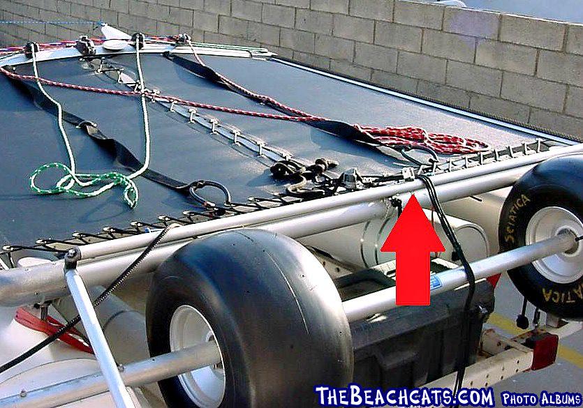

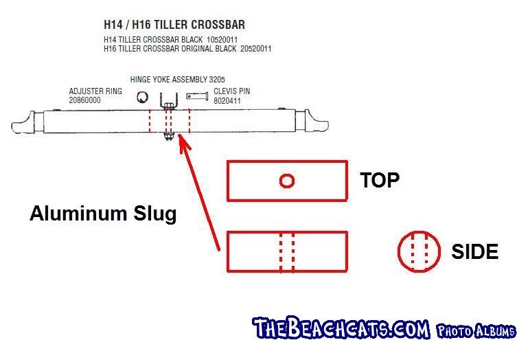

  • The Hobie 16 tiller tie bar uses a slug about 2" long with a 1/4" hole in it at the center where the hiking stick connects. With a 1/4" hole in the tie bar at the center (the greatest point of stress) the tube strength is compromised and the slug acts to reinforce it.
    http://www.thebeachcats.com/gallery2/main.php?g2_view=core.DownloadItem&g2_itemId=119593&g2_serialNumber=3
    http://www.thebeachcats.com/gallery2/main.php?g2_view=core.DownloadItem&g2_itemId=119597&g2_serialNumber=3
    Do the Nacras use such a reinforcing slug at the center of the tie bar? I didn't find one on the 5.0 I'm restoring.
  • Not that I'm aware of. Neither of my boats have that.
  • Thanks Dave. Just checking and confirming comments from others welcome.
    I've seen Hobie tie bars collapse at the center before when folks have removed the hiking stick yoke (as in the 1/4" bolt that it attaches with). The slug can move in the tie bar tube so if you don't know it's there and to find it before reassembly, no slug, no reinforcement = potential collapse.
  • I believe the Hobie cross bars are thinner walled tube. I've never worried about that on mine.
  • The Nacra does not have such an item, nor is it required. I'm not very familiar with the Hobie setup, but I've never heard of a Nacra tube collapsing.
    If you do a stress analysis, you realize the 1/4" hole has very little effect. The hole is drilled close to vertical. The stress on the tube,(jamming the hiking stik back, or yanking it forward) wants to deform the tie bar in the horizontal plane.
    Lets say you pull hard forward. The force is applied to the tie bar through the connecting bolt. The tie bar wants to deflect forward. However, this means the metal in front of the bolt has to be stretched,(under tension), while the metal behind the bolt would have to compress. The wall thickness of the tube is such that almost nothing moves. The vertical hole does not compromise the integrity of the bar.
