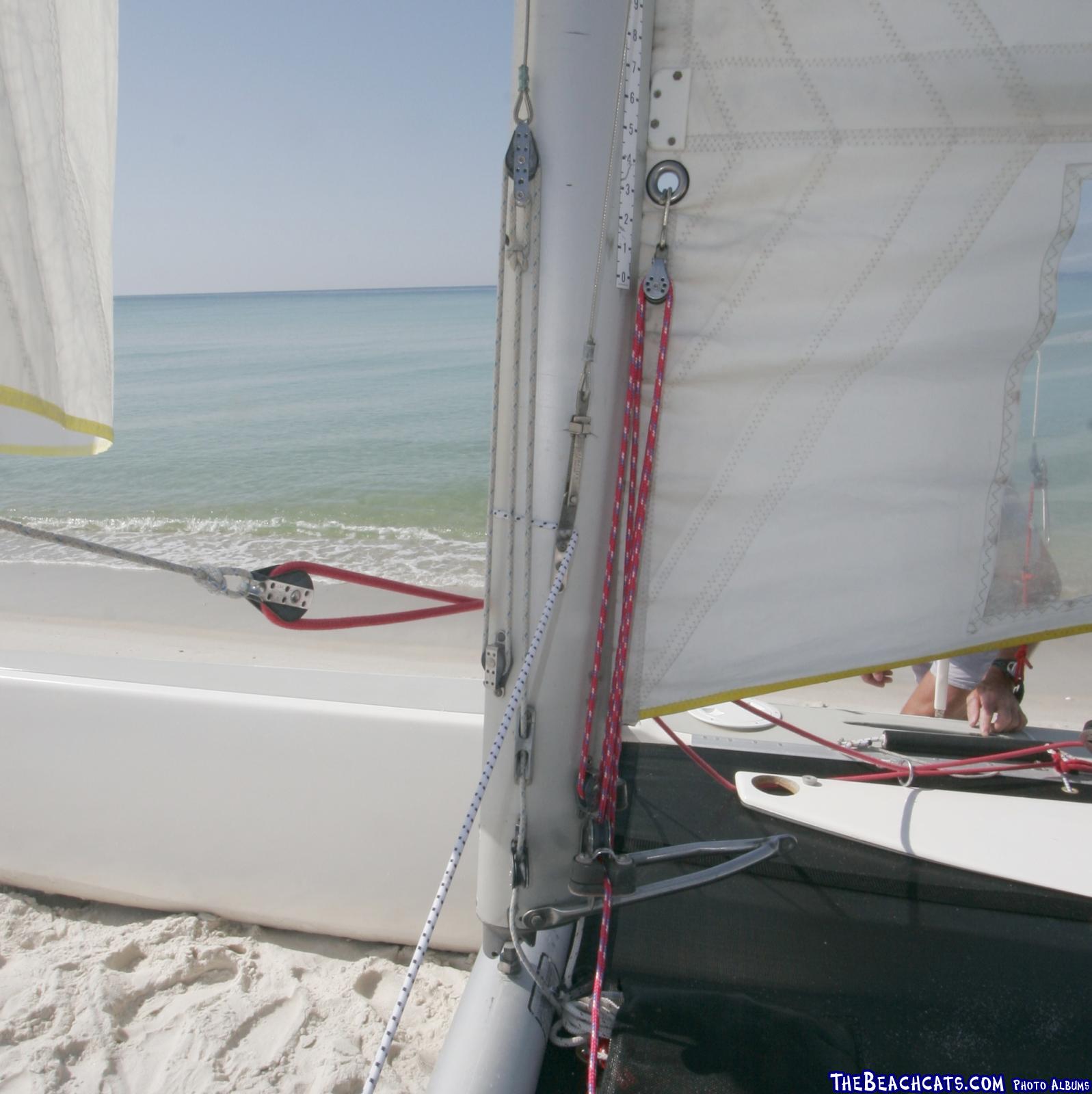

  • green....
    this is how the jib halyard was rigged on one of my Nacra 5.8s. the blocks allowed for purchase and the block at the bottom meant i could raise or tension the jib from any angle. dropping it was another issue. hope this stimulates your thinking!
    j
    http://www.thebeachcats.com/gallery2/main.php?g2_view=core.DownloadItem&g2_itemId=119397&g2_serialNumber=3
    '99 Nacra Inter20 (sold)
  • The 5.7 uses the same setup Arch posted above, the smaller 5.0 uses a simpler system. You probably have a portion of the jib halyard wire, & the rest line.
    It should travel through a wire block up near the mast hound, then down alongside the mast. You get a 2:1 from the wire block on the mast.
    There should be an aluminum clam cleat,same as shown in Arch's photo,(some had a "horn cleat) near the base of the mast. You just haul the jib up, & put line in clam cleat, or around horn. If there isn't one, there are probably holes where one used to be. Buy the clam cleat & rivet on.
