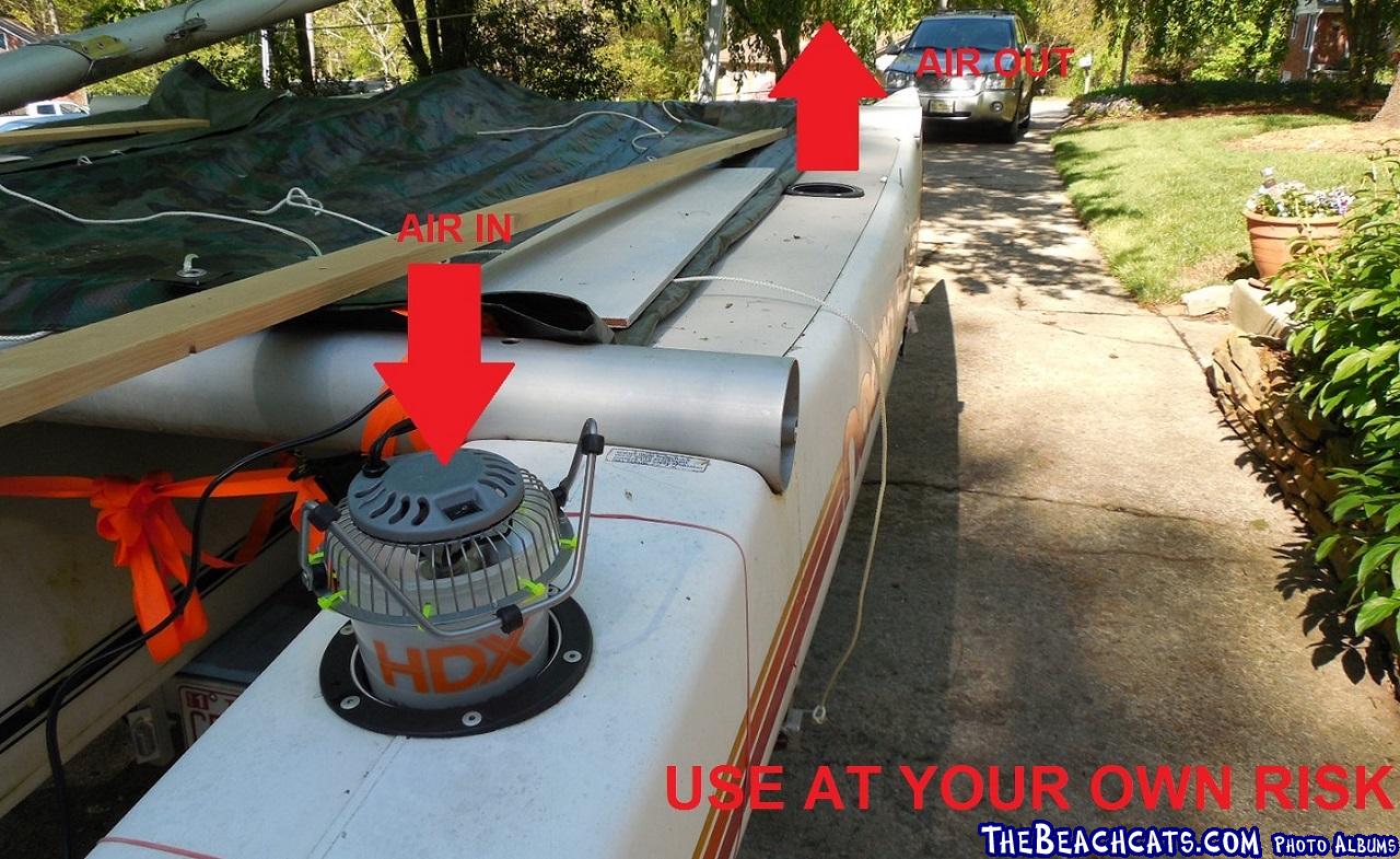

  • A simple to build fan setup to get your hulls bone dry. Convert a $ 7.99 fan, a $ 1.28 paint bucket and a few tie wraps in to a shrouded/ducted fan that fits perfectly in a 4" access port.
    http://www.thebeachcats.com/gallery2/main.php?g2_view=core.DownloadItem&g2_itemId=113611&g2_serialNumber=3
    See album for detailed info., 5 photos:
    http://www.thebeachcats.com/pictures?g2_itemId=113469
    Note that if you use the paint bucket shown, the fan blade tip to shroud clearance is very tight (good for efficiency!) so check the blade for freedom of rotation (FAN UNPLUGGED) prior to powering it up.
    BUILD AND USE AT YOUR OWN RISK
    Three cheers for dry hulls = lighter cat = faster cat = trophy(maybe)

  • That's awesome, I love some "hardware store engineering". Very nice and simple.
    I've imagined ducting a large dehumidifier up as a closed loop so you could measure how much moisture came out. icon_biggrin

  • Absolutely no risk of damage to the hulls from a fan this small. Besides it's ported to atmosphere at the out access port. You would need a precision manometer to measure the delta P.
    Simple draining with bows high, drain plugs out, will work with time. This is to speed up the process. I'm not sure why you feel you need toweling, but to each his own.
