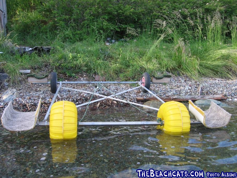

neat setup!
I purchased a winch from HF to help me push my boat into the backyard but haven't had success with it yet.
It suffers from a terribly bad duty cycle and goes into thermal shutdown very quickly in the fl heat
I need to figure out a better anchoring system - what do you secure the winch wooden base to? (a tree i assume)
Edited by MN3 on Mar 07, 2015 - 06:54 AM. -
- Registered: Oct 26, 2002
- Last visit: Sep 23, 2019
- Posts: 390
Yeah, in this case a tree. I have another winch for the ARC mounted to an alum plate with 3/4" holes in the four corners, and then I drive four 1' pcs of rebar into the ground to secure, that works well in the gravelly soil we have around the lake. -
- Last visit: Dec 04, 2024
- Posts: 7090
cool thanks!
i think i need something with a footer here in the fl sand
how many feet are you pulling the boat?
Edited by MN3 on Mar 07, 2015 - 12:16 PM. -
- Posts: 390
Yeah, bury a pc of 4 x 4 and tie to that. The cable on the drum is 50', High Voltage uses less than 20, maybe 30' for the Fringe on a different beach. -
