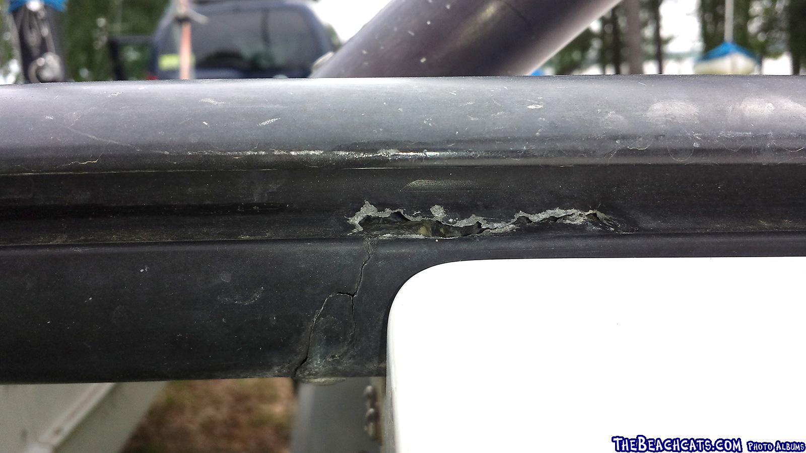

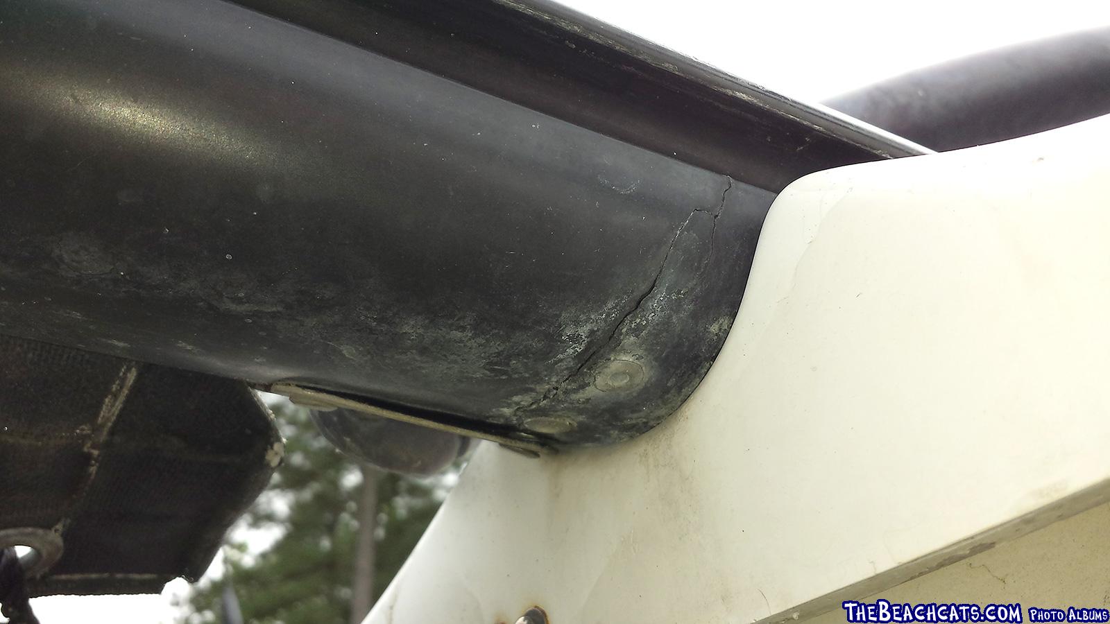

BAD Hobie 18 Rear Beam Corrosion  Bottom
  • I've got such bad corrosion on my rear beam that the starboard end is in danger of breaking completely in two.
    Anyone seen anything like this before?
    http://www.thebeachcats.com/gallery2/main.php?g2_view=core.DownloadItem&g2_itemId=112974&g2_serialNumber=3 http://www.thebeachcats.com/gallery2/main.php?g2_view=core.DownloadItem&g2_itemId=112968&g2_serialNumber=3
  • looks like metal fatigue to me
    if i recall those rivets hold a slug in place that the beam bolts use - i had cracks in my h18 rear beam that had to be welded. the jerk welder sanded the rivets off and never did anything about it. he returned my beam to me and the slug would just slide around

  • goodsailingThen maybe the slug will provide enough support to keep it from breaking off while sailing. icon_biggrin
    I see absolutely nothing that is funny about this.
    Damon: Need help finding a replacement? Not sure I'd trust a weld.

    Truth is, without knowing how many times this boat has been sailed with the spar in that condition would lead one to believe the slug has held it together. If that is the case, welding a brace would work if a riveted slug has supported it. But it appears there's plenty of replacement spars are available.

  • MN3looks like metal fatigue to me
    Agreed.
    There is some corrosion but it is minimal, happening after the fatigue opened to let the saltwater in.
  • Quotehere is some corrosion but it is minimal, happening after the fatigue opened to let the saltwater in.
    Couldn't there be greater corrosion on the inside of the tube than what you see on the outside?

  • goodsailingCouldn't there be greater corrosion on the inside of the tube than what you see on the outside?
    Good question.
    If the corrosion were greater on the inside, his crossbar would have folded already. Its kinda amazing that it has held together this long.
  • QuoteIf the corrosion were greater on the inside, his crossbar would have folded already.
    Not necessarily.
    Lets take it apart and get the facts.
